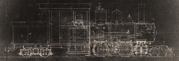

Blueprint of #11.
(drawing by Jason Lamontagne)
