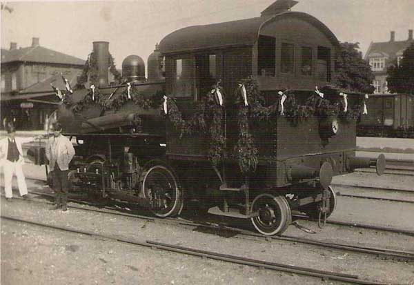

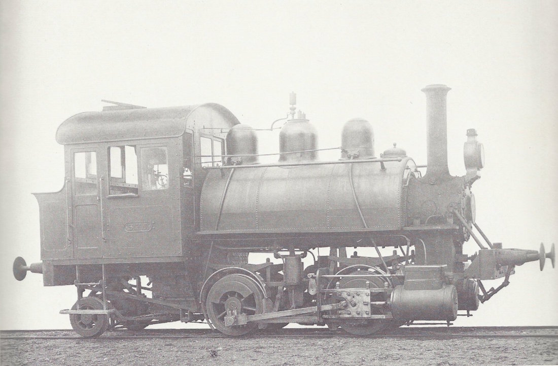

There has been recent interest from some of the higher ups within our club about this locomotive, and whether or not any technical info exists for it. So, I know that finding records and drawings for Baldwin locomotives can be a huge mess, and that sometimes nothing exists at all, but I am hopeful that someone knows something about it.
So, here goes what we know about it already...
Its a Baldwin 0-4-2T built for the Sydfyenske Jernbaner in 1899
Its construction number is 16293
It was scrapped in 1932
It had a boiler pressure of 10 bar
Driver diameter of 39" or .99m
Loaded weight of 22 tons
Empty/dry weight of 19 tons
Coal supply of .5 tons
Water supply of 2m^3
A length of 7.63m or 25'
And an estimated max speed of 35-40 kph
We would be most interested in finding drawings and the data specification card. From my understanding, its status as a foreign export locomotive makes it slightly more likely to be found...?
I will also be contacting the Danish state railway museum, since DSB took over the rail line in the 1940's. Hopefully they might have something hidden away in their archives!

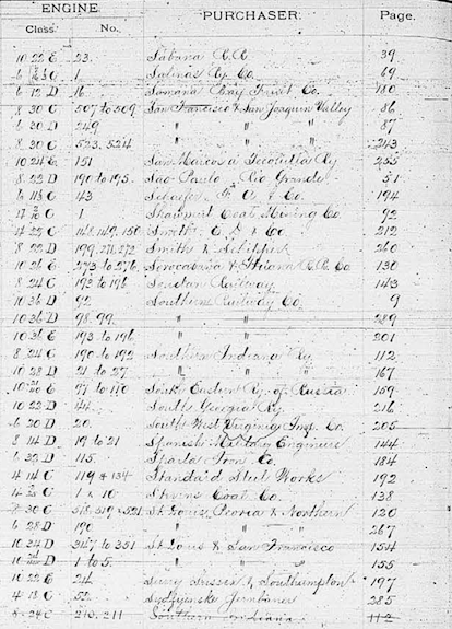

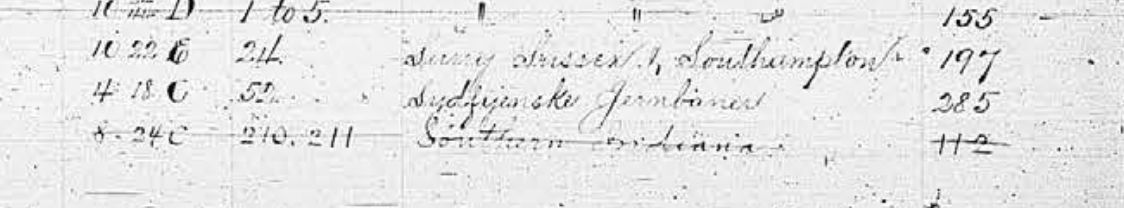

So after a quick search through the DeGolyer library online material, I managed to find this about the locomotive.
In volume 21 on page 11 of the Baldwin Locomotive Specifications book this information was present
Engine
Class: 4-18C
No.: 52
Purchaser: Sydfyenske Jernbaner
Page: 285
So am I to assume drawings for this locomotive would have an identification number of 4-18C and that 52 means its the 52nd locomotive built to these plans? Also, what does it mean by page 285?

Yes, 4-18 C would be the Baldwin class number, which is to say the basic model of locomotive, and 52 means the 52nd engine built to that design. As Dave has noted above, this was a stock industrial locomotive, so there were a lot of them (meaning 52 was early in the series).
Scanning the SMU DeGolyer Library index, I see listed a number of erecting card drawings for other 4-18 C engines, and even a few detail drawings for particular parts of 4-18 Cs (a drawing for the saddle tank of 4-18 C 101 built for Great Lakes Stone & Lime in 1914, for example), but none for this particular engine. The closest set of erecting drawings I see on the list are for 4-18 C 58, built in 1902 for Robert H. Foerderer, It might be worth a look, and certainly better than nothing.

Possibly, but it is my understanding that the first photo is the builders photo from Baldwin itself...?

So I have it on confirmation that the locomotive was originally built as an 0-4-0 when it left Eddystone, and that the -2 came in 1900 when the SFJ found it to ride hard on the rear axle. Problem solved! Now I just need to find/piece together a complete set of drawings for the locomotive as built, and then hope to god the drawings for the modification exist somewhere that make the locomotive truly unique!

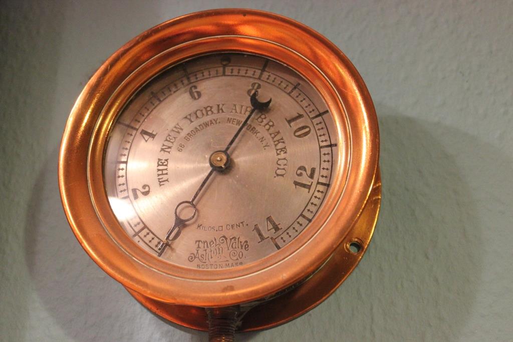

On an incredibly interesting side note, a discussion with a friend at the shop today revealed he has an original gauge from the locomotive! Its made by the New York Air Brake Co., but I am slightly confused if it is actually for air brakes... The locomotive had steam jam brakes as we have all figured out, and every air line gauge I have seen in the club's collection only goes till 10 bar. Being that it goes to 14 bar, could this have been used as the main steam pressure gauge...?

The gauge is clearly marked for Kg per CM squared, not atmospheres. Perhaps it was steam jam pressure? Bourdon gauges are similar, but the main steam variety I have seen are somewhat more robust than those for brake systems. How does Kg per CM squared compare to atmospheres....and how high above seal level?

One Kg per cm equals something like .769 atmospheres if I remember correctly from my boiler lessons. I honestly have no clue how altitude would influence that measure though!
On a side note, if opinion is that this is definitely brake related in some way (besides by mfg.), we are looking adding a single lung brake pump on the locomotive under the cab floor, and it could be used for that. Brake line pressure in Denmark (maybe all of Europe..?) is 8 bar.
