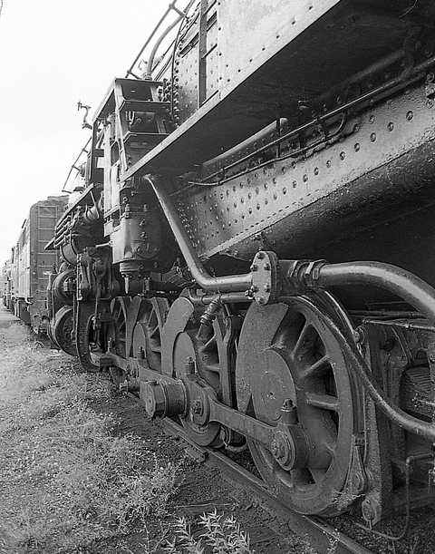

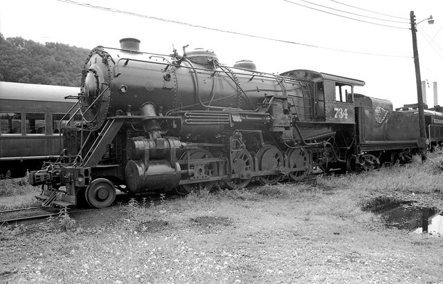

Posts: 329
My understanding back then was that the Feedwater Heater on WMSR #734 was damaged and deemed not repairable as to why it was removed and not replaced during the rebuilding.

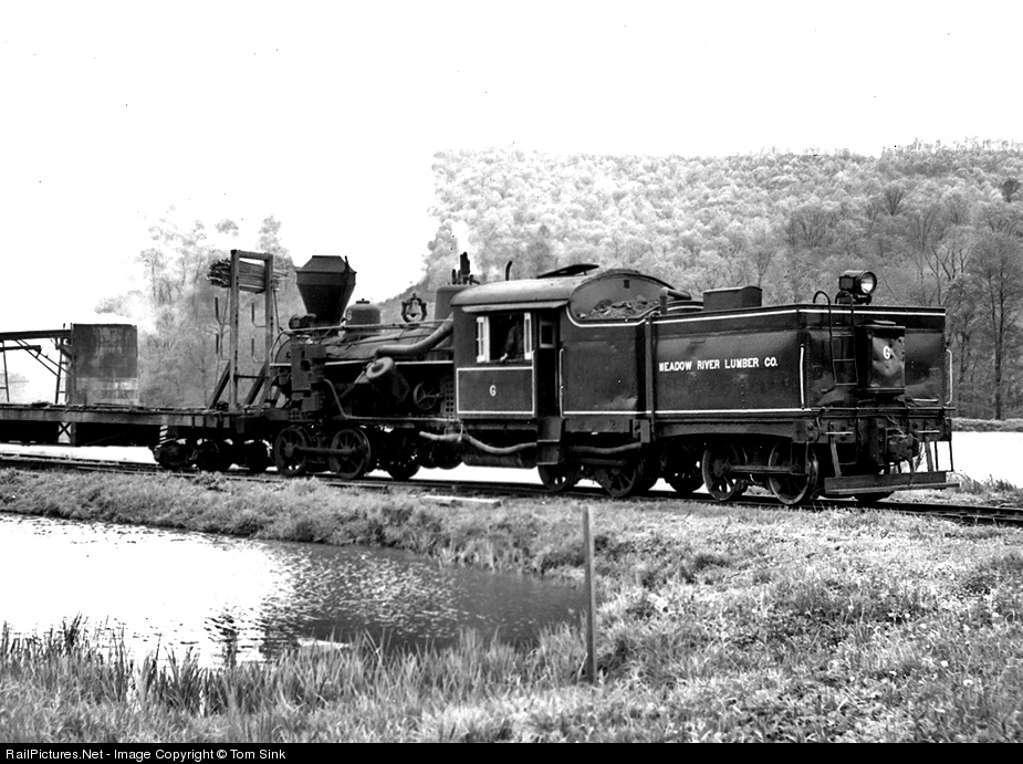

Didn't Cass Heisler No. 6 have one of these when it was owned by Meadow River Lumber Co.?
 Post subject: Re: Existing Worthington BL Feedwater Heaters
PostPosted: Sun Apr 17, 2016 4:25 pm
Joined: Sat Oct 02, 2004 1:45 pm
Posts: 68
Yes. There is a photo of it at RailPictures.net taken by Tom Sink.
Don Fenstermacher
