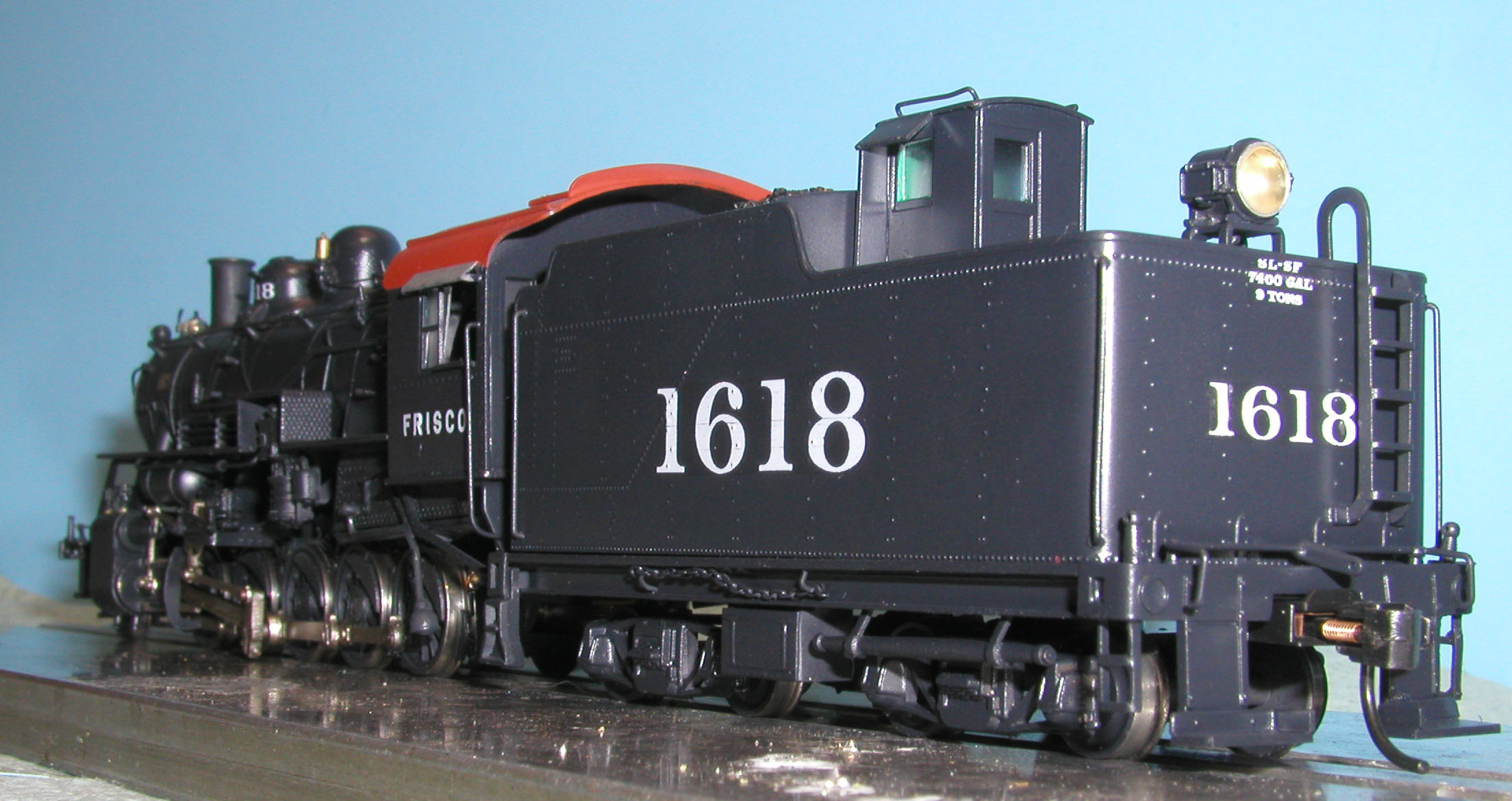

This is one of my HO models that I've painted and lettered, but the tender rear is lettered correctly.
The interior of the doghouse just had a "bench" in it, a light and a foot warmer.
Hope this helps.

This helps immensely. Do you happen to have the measurements for the lettering at the top rear of the tender?

If memory serves, it's 2". Engine number is 12" Number on side is 24" Cab is 8" and sand dome is 6".
Many years ago I sent Dave Conrad the drawings for the doghouse and thought I had included some photos with it. That's what they built the doghouse from.
