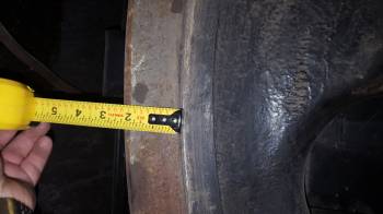

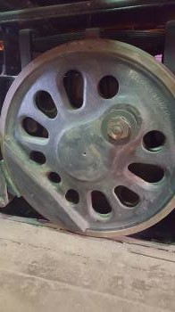

ASR and Fireup2100 held a small work session on April 2. Attention last Saturday focused on measuring tread wear on the eight drivers. Volunteers in attended included:
Greg Brown, Paul Volosyn, Steven Harvey and contractor Jason Sobczynski
The drive wheel tires were measured and it was found the tires are cupped. While they could be turned, the final measurements would be very close to the FRA limit of 1 7/8". The portable mill hog is now at the roundhouse to cut the new gasket surfaces for the wash out plug seats that are badly pitted. This week also saw the start of the firebox ultrasound testing by contractor Jason Sobczynski.

So are you implying that the 2100 is to get new tires before it runs? What are the pros and cons of reprofiling the existing set and running them until they are condemnable vs. replacing the tires now? Would a reprofiling last until the 2100's 1472 days have expired?

That would depend on how much you run it. If it's a roundhouse queen, they would last indefinitely.

ASR undertook the 2100 project to return her to operating condition, not to simply relocate her to Ohio. If reprofiled, the tires will pretty much be at the condemnation limit. It does not make financial sense in our minds to dewheel the engine to reprofile the tires among other things, only to have to then replace the tires after only a few years of operation, if that.

Would you be dropping the drivers if not for this issue? Could they be reprofiled with a Lidgerwood or similar device to forestall the tire project a bit?

Filmteknik, yes, a Lidgerwood would work for truing the tires, however, after 5+ years of sitting in a wide open, high desert environment, we also want to thoroughly clean out all of the running surfaces in the boxes and also true up the crankpins while we are at it. While we have not totally committed to this route, quite yet, we will exhaust both options before making a final decision. I know crankpins can be trued up in place as many other locomotives have had theirs restored in a similar manner as well such as SP&S 700 for the truing of the tires.

Smart decision, Rob. While you have her down, do it right the first time.
