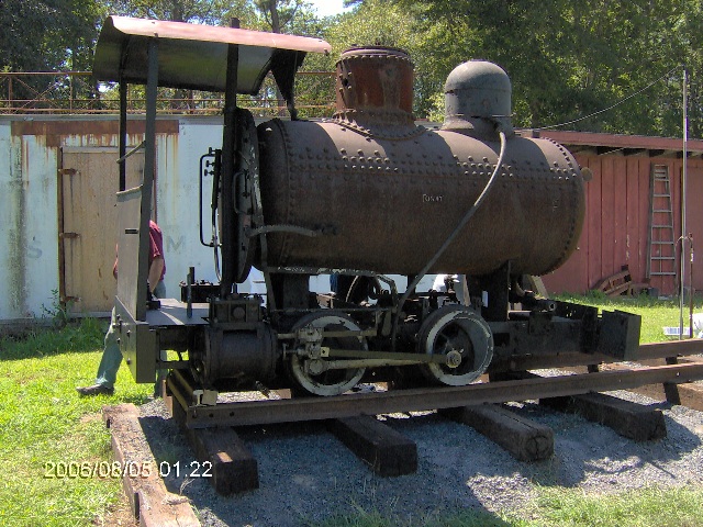

We do not have a formal stack on our little Porter. Twin pipes run from the cylinder area up through the cab roof, keeping in mind that the cylinders are at the rear, or cab end of the locomotive. I believe as originally built, there was a single pipe coming up through the cab roof. The enclosed picture gives you an idea on what the pipes look like and the lack of drifting valves as well.
Hope that helps,
J.R.
