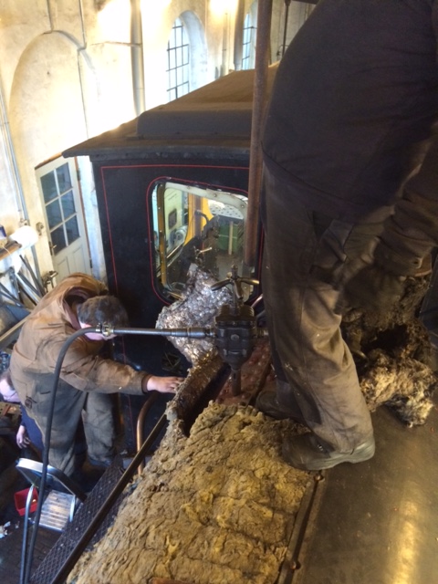

So we are replacing a few top or radial staybolts. Apparently, this is the best method we could come up with to support the drill.
What do you do? Any better suggestions?
File comment: The air drill after drilling out a staybolt.

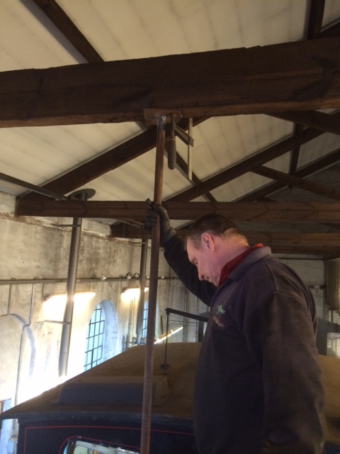

File comment: The brace clamped to a ceiling truss

physically holding that drill can be rough especially if it cogs up it'll wrap you around.
