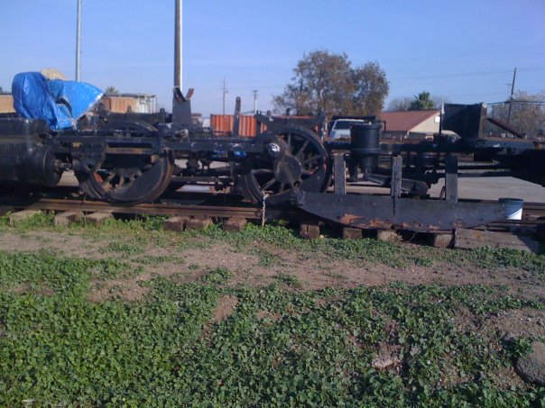

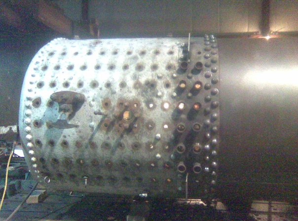

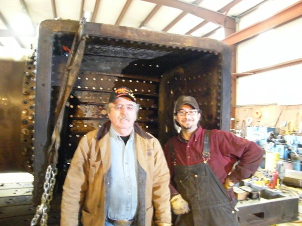

Just because something looks to be in poor shape does not mean it is down and out. A picture of my locomotive (Santa Cruz Portland Cement #2) two years ago looked like the first picture. The second picture is of the running gear after new tires, remachined wheel centers, remachined axles, new crownbrasses, remachined axle boxes, new spring rigging and rebuilt/new springs, etc. The final pic is of the boiler with new barrel, firebox, and smokebox after being erected on the frame. Sometimes they look rough while the rebuild process is underway. I am not sure if this is the case for this particular engine, but feel the need to point out there may be hope for this locomotive. I think most people would have counted SCPC #2 out as well. To be honest, the NHTR #38 looks to be in a bit better shape! Come visit our website for more information at:

Stathi-who fabricated your new boiler/firebox?

Is there any part of the old boiler you saved? It looks like everything is new. Great work. Please keep us posted.

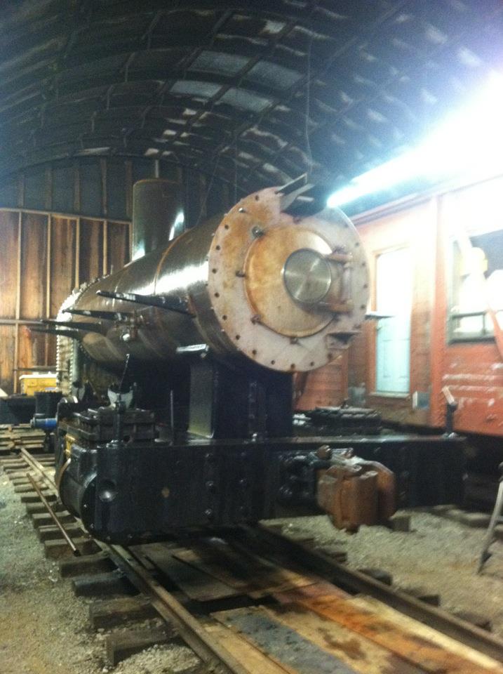

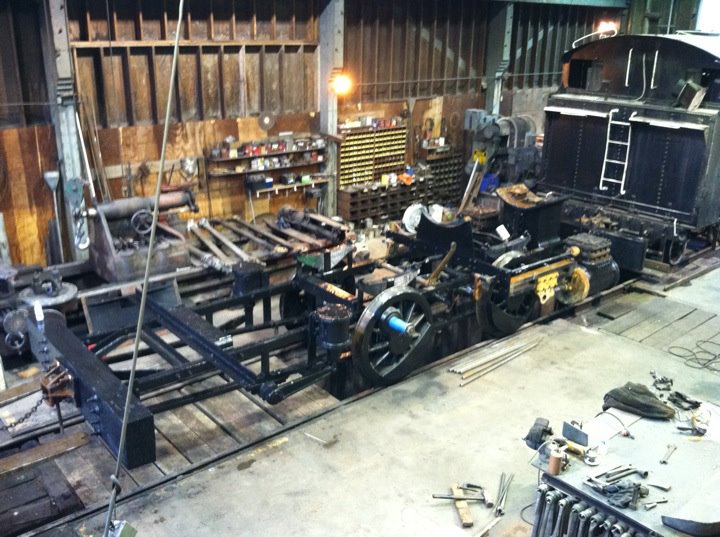

Over the last two years we have done the boiler work in house in accordance with FRA, NBIC, and applicable ASME code. The only work farmed out was the rolling of the barrel sections and the NDT of the weld seams in the barrel and firebox. Here are some photos of the work as well as some my friends who have been involved with the project. These have included professional boiler-makers, talented steam mechanics, and interested railfans. A locomotive can only succeed if the people around it are dedicated to the project, and this little engine has found a lot of friends without whom, none of this would have been possible.
