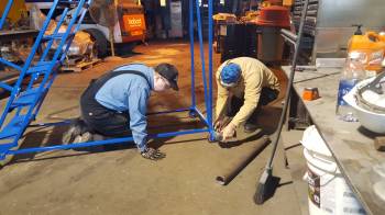

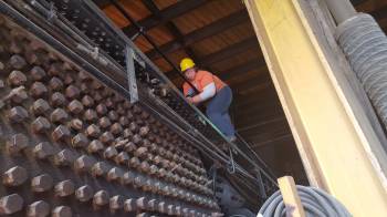

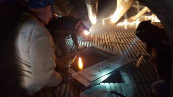

This week saw the gridding of the firebox get started. This task is more than 50% complete and will be completed next Saturday. Then UT readings can be started. Lapping of four (4) more washout plugs were completed. Volunteers started removing tools and parts that were placed in the auxiliary tender for shipment from WA to OH. The hydro-testing tool for the superheaters was found in the auxiliary tender and placed in the storage container for future testing of the superheaters. Inspection of the auxiliary tender wheels, bearings and brake rigging was started as well. The last component from the failed oil firing system was removed from the middle of the firebox; that being a fabricated steel damper. This will allow the four (4) missing rocking grates to be reinstalled next. Lastly, new safety stairs were assembled and set in place at the back of the cab to provide a much safer means of getting in and out of the cab.

• NOTE: Jason Sobczynski has secured the use of a portable Mill Hog that mounts to the interior of the washout plugs and will allow us to cut new gaskets seats on the worst of the badly pitted gasket seats saving many man-hours that would otherwise take week to complete by hand. Approximately 12 of the washout plug seats will have new seats cut in this manner.
• Continue lapping the medium size washout plug gasket seats

File comment: Gordon, Chris, Jake and Perry wield the "gas axe" as they dismantle the homemade air damper in the firebox. The missing 4 grates will be installed at next week's work session.

File comment: Tiffany pauses for the camera while lapping another washout plug seat.

File comment: Here, Gordon and Eric assemble the new shop stairs donated last week. Volunteers now have a much safer means of getting in and out of the cab of 2100.
