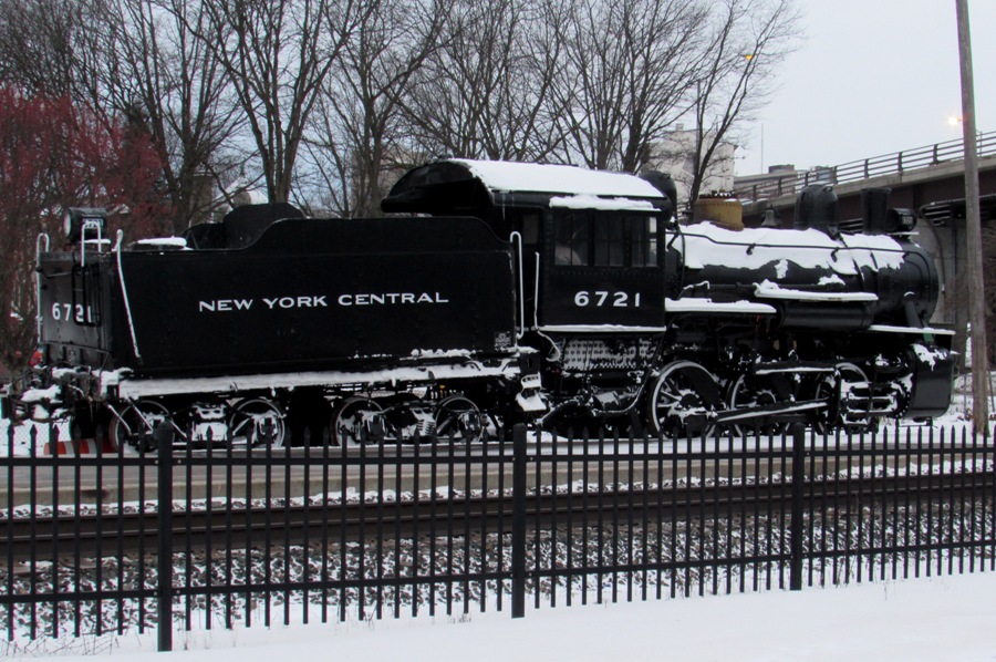

Six months after a runaway covered hopper off the NYS&W collided with New York Central 0-6-0 6721, the locomotive remains at Utica, NY's Union Station awaiting repairs. Insurance negotiations are ongoing. Photo taken this morning.

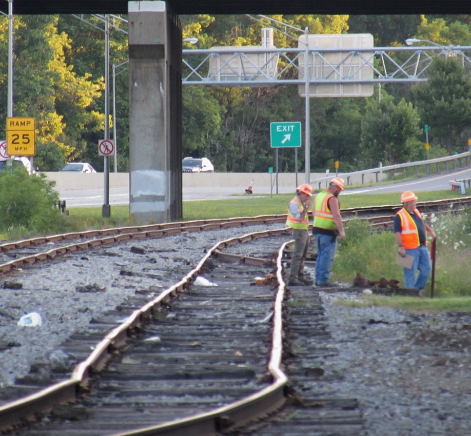

The covered hopper traveled approx 2.5 miles before colliding with 6721, including rolling down 6/10th mile street running on Utica, NY's Schuyler Street. It ran over a derail approx 1/4 mile into its journey; below is a photo showing railroad employees checking the derail shortly after the event.
Estimated top speed was 40MPH.

If flop over derails are unreliable over about 20 mph, why use one on a track that allows cars to runaway at 40 mph?
 Post subject: Re: NYC 0-6-0 6721: 6 Months After Collision With Runaway Ho
PostPosted: Mon Jan 25, 2016 6:10 pm
Which is why many railroads (UP for example) now specify split-point derails for protection of mainline tracks.
PostPosted: Mon Jan 25, 2016 6:55 pm
The derail in that photo is open. I haven't seen an accident report, but unless someone testified that it was still closed after the accident, it wouldn't have done much good anyway.
