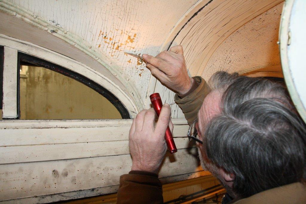

I have a question regarding how to strip layers of paint to get to a paint color or decorative pattern underneath layers of paint. We have CA&E 315, a 1909 Kuhlman car in our collection at the Rockhill Trolley Museum and we are starting (again) on the restoration of the car, We need to strip the interior ceiling panels to reveal a pattern that was applied around the edges of the ceiling panels. We have recently obtained an interior builders photo and while it is a terrific image, it will not give us the details to reproduce this pattern.
Besides the answer of “very carefully” how does one go about stripping layers of paint to reach a layer that you desire without destroying the layer that you need? Are there special tools recommended or a procedure? It appears that there are two different materials used for the ceiling panels, different in the smoking compartments and the coach section. In the smoking section, the paint is cracking and getting the pattern may be a bit easier as it may be able to carefully scrape the paint away. The paint in the coach section ceiling is adhered much better (unfortunately) to the ceiling panels.
Any suggestions are appreciated. Thanks in advance.

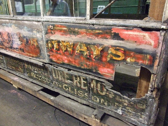

To find details of former colour schemes/lettering under layers of paint, we have used very fine grade abrasive "wet & dry" paper, which, although it takes many hours of delicate work to remove the layers of paint, the results can be startling, and you find the unexpected!
We have a former Cambridge double deck horse car in our Museum collection which was similar to the ones used in Ipswich and which is currently undergoing restoration to its Cambridge Street Tramways condition. It had been withdrawn in 1914 and the downstairs body section was used as a garden shed up to the late 1970's/early 1980's, eventually finding its way to us about 7 years ago.
We needed to reserach the Cambridge livery for the restoration and one side appeared to have outlines of lettering under some paintwork + remains of an advertisement, so a couple of our members started the labourious task of rubbing down the paint applied when it was a shed..........
The advert is fairly obvious in this picture, but note the state of the panels below the windows.
Careful rubbing revealed the Cambridge livery and lettering.........

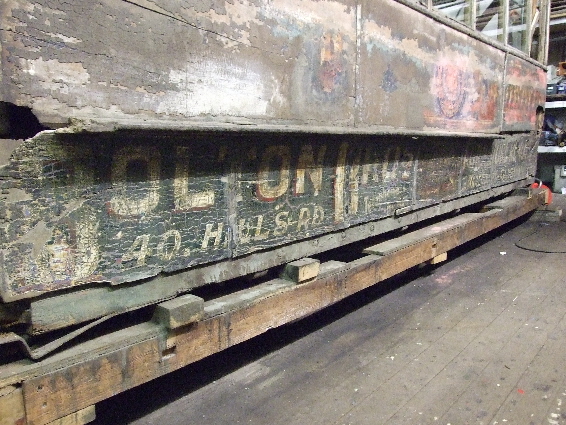

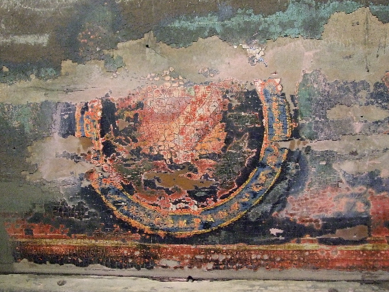

and this circular device appeared with part of a "7" visible which gave us the Cambridge fleet number
However, underneath the remains of the fleet number, we then discovered the City coat of arms of Bradford, in the north of England which was totally unexpected !

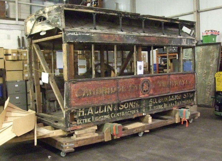

Once the rubbing down was complete, we ended up with this.......
The gold "Cambridge Street Tramways" lettering is clearly visible, as is the circular device with the Bradford coat of arms in it (which overlaps the "Street" lettering).
The advertisement on the bottom panels is much clearer now (although this picure is of the other side of the car to that shown in the picture in the previous post.)
All of these panels have now been removed and conserved for display next to the restored vehicle.
The Bradford crest proved that Cambridge bought it secondhand, but further finds have more or less worked out its history as follows...
Built in 1880 as a single deck car by Starbuck of Birkenhead for Bath Tramways Company (either fleet #3 or 6).
Sold to the Bradford and Shelf Tramway around 1884 and used as a trailer behind a steam "dummy". Whilst there it was converted to a double decker.
Sold to Cambridge in 1894 as their #7 and ran until the system closed in 1914.
Most of the above would never have come to light without the painstaking rubbing down of the paintwork.
