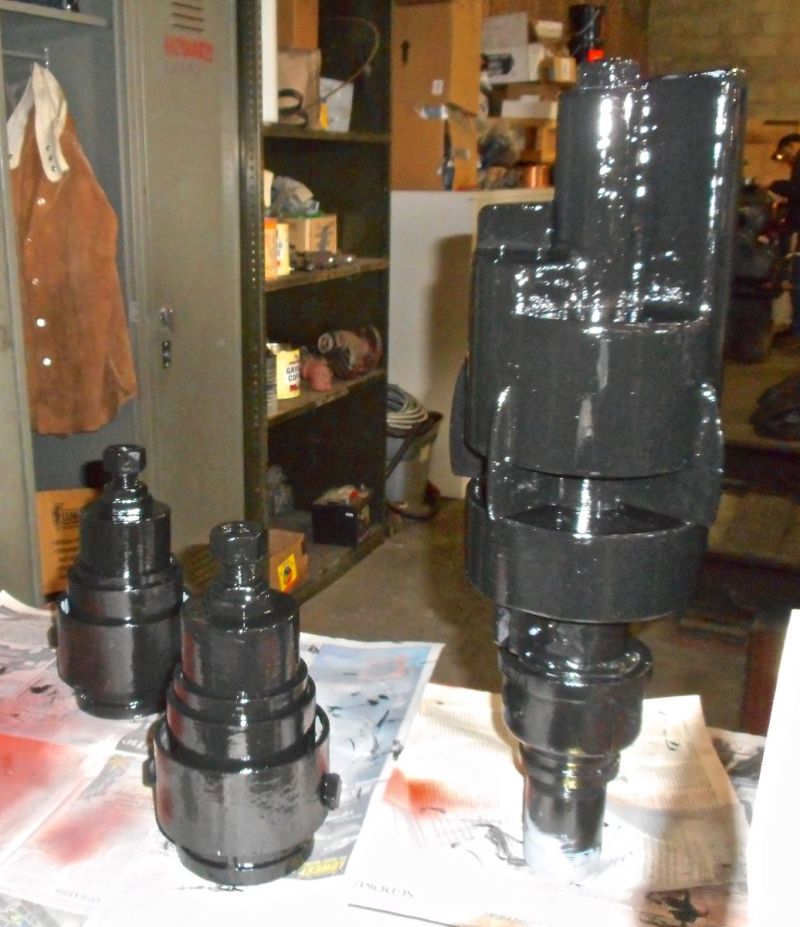

Fabricated non-functioning replica whistle and safety valves we built and installed on ARR 556 on display in an Anchorage park to replace items that disappeared 40-50 years ago.
