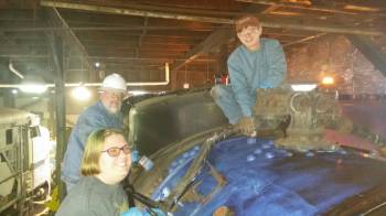

Jake Crayton, Chris Howell, Tiffany Saultz, Kevin Anderson, Forrest Nace and Rob Gardner brushed and rolled on the rust converting primer over the firebox and boiler shell, smoke box and cylinders.
This primer will help provide a smoother, sealed surface to ward off additional oxidation to the boiler shell and also help pull rust from the steel boiler shell for future removal prior to application of heat resistant primer and paint. The primer went on with a noticeable blue tint, but dried fairly clear. And, no, we are not going for that “Thomas” look, lol.
