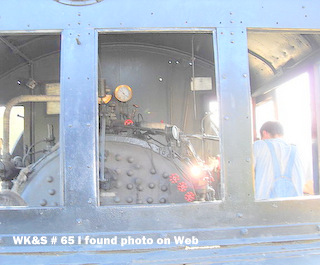

Hi David
I found this photo of WK&S # 65 on the Web ,,Pat

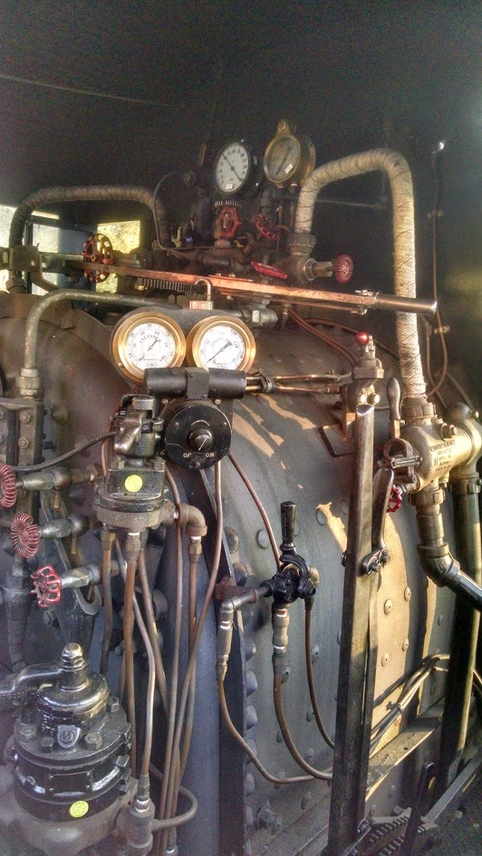

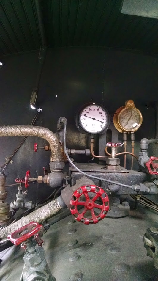

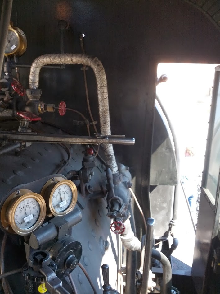

I think J David has access to more than a few steam engine cabs. He's looking for some pretty specific mounting ideas.
I know its an 0-4-0, but St Elizabeth's #4 at the B&O is a Porter saddletanker. Here's some pictures that I happen to have in my files. I can try to get some more next time I'm up at the shop. George could probably get you some as well (I'm pretty sure you know how to get in contact with him, if not let me know). Hope these are somewhat helpful.

Is that a key lock on the quadrant of the throttle? Was that a common way to secure a small steam locomotive?
Thanks,
Bob
 Post subject: Re: H.K.Porter 0-6-0T cab interior photos needed
PostPosted: Mon Feb 29, 2016 1:24 pm
Joined: Mon Jan 08, 2007 10:56 am
Posts: 55
It is a lock. I'm not sure if it was common, but it's what we do.

C. Edwards wrote:
We used to lock the throttle and chain the Johnson bar to dead center when we were putting the locomotives to bed on the CP&LE
