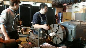

Brian Tusin and contractor Jason Sobczynski machined approximately 20 each Teflon gaskets for the washout plugs.

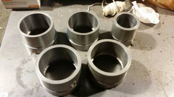

Gordon Hartschuh, Paul Volosyn, Greg Brown and Forrest Nance continued lapping washout plug seats.

•Machine two (2) more lapping tools for the medium sized gaskets
•Start lapping the medium size washout plug gasket seats

File comment: Jason and ASR machinist, Brian Tusin, turn hard Teflon washout plug gaskets on the Pacer lathe.

File comment: Photo of the two sizes of lapping tools machined by Jason Sobczynski.
