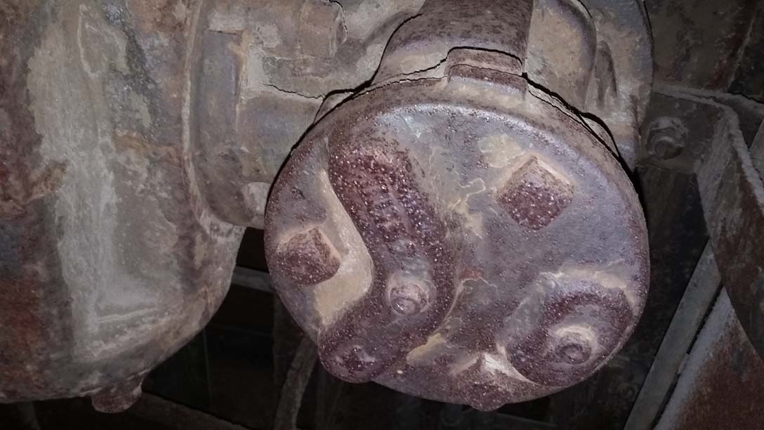

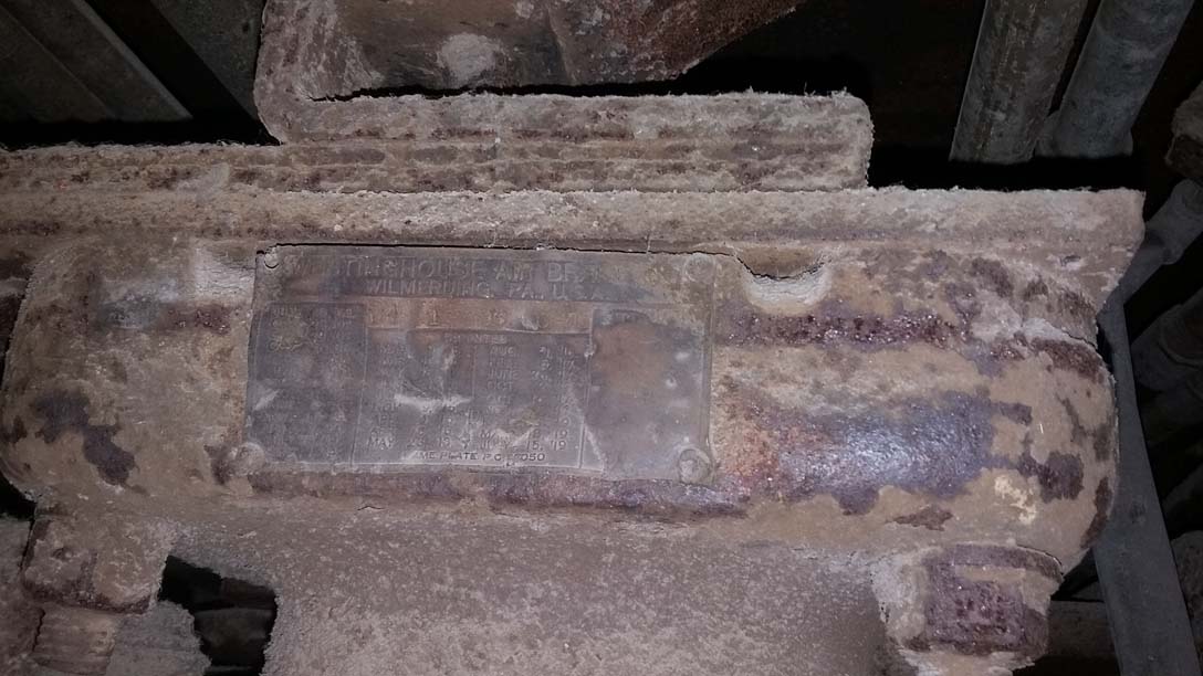

Doing some research for an upcoming project at the Southern Michigan Railroad. Does anyone here have any information on the brake systems of these cars? Our car was the class unit of the first order built by Pullman. From what little information I have found it was equipped with AML? brakes originally. And it is rumored to have a U5 brake valve. Currently the control stands are cutout on the car and we run it as a normal passenger/freight car behind our 44 tonner.
We have had problems with the car slamming the brakes hard on with only a 5-10lb reduction. Adjusting the slack and lubricating key points has not helped thus far. I have not yet rolled under the car this winter to do a more thorough inspection as I have been busy with other projects. Well that and crawling around under a car stored outside in a Michigan winter is not much fun.
Would CSS have upgraded any of the brake valves over the years before the cars were retired in the 80's?

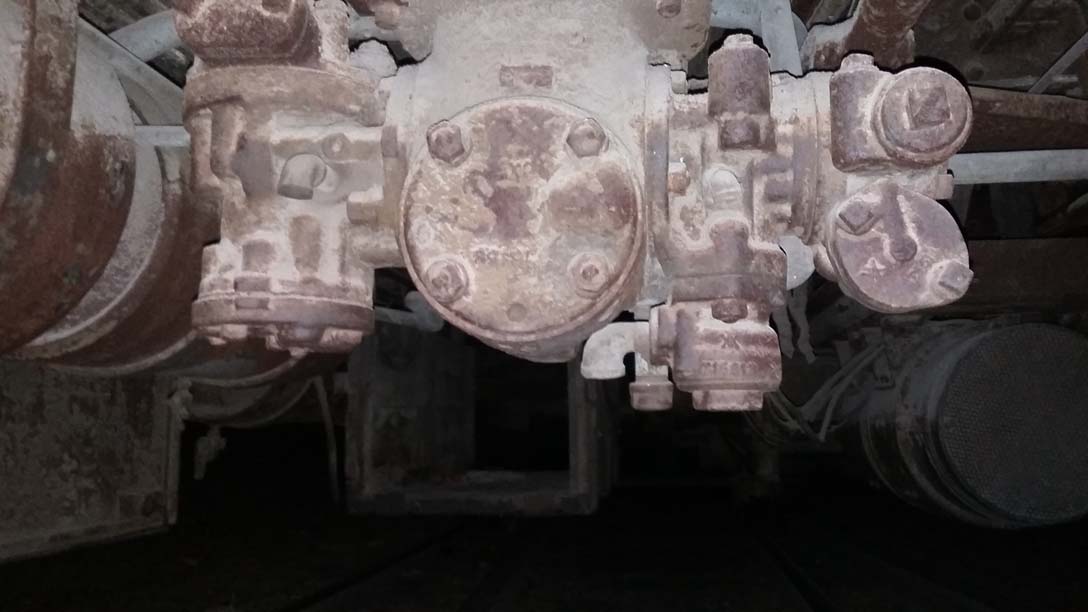

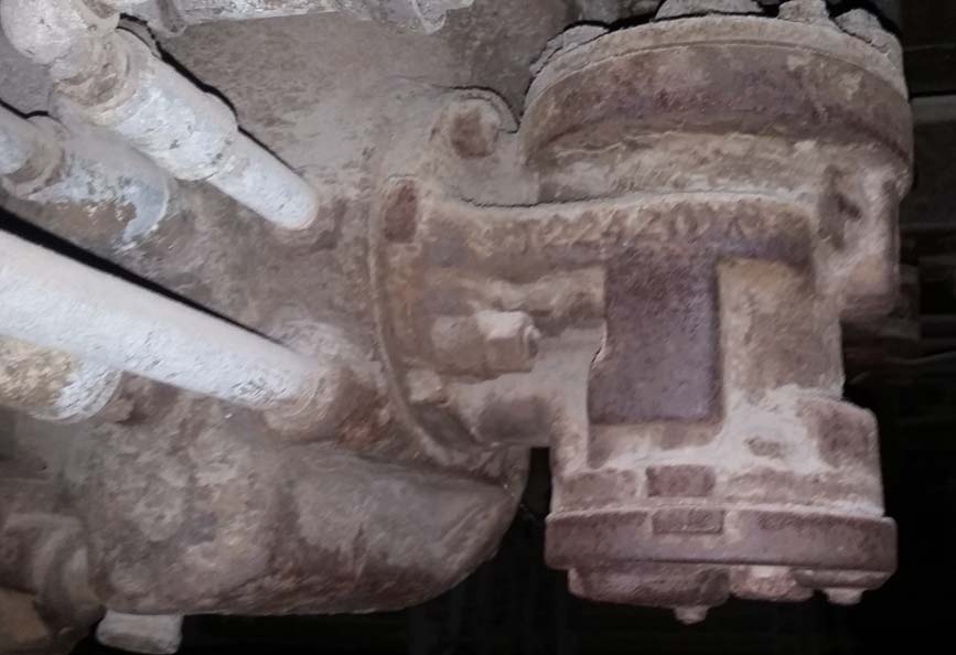

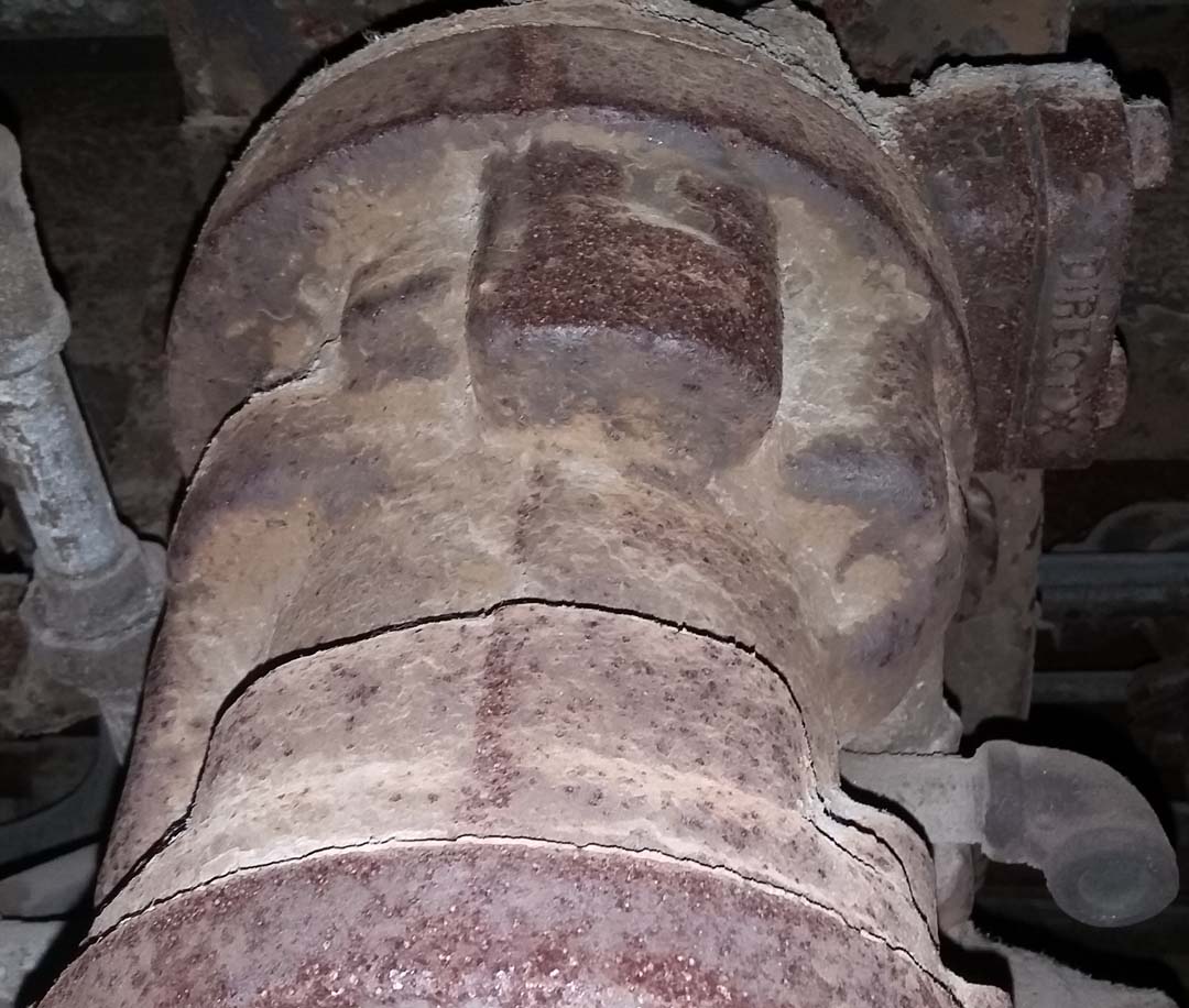

Looks like a universal valve to me. It could be a U-5. I think the U-4 was common for the Chicago Elevated lines and the Insull interuban lines.
I'm familiar with the U-5 because that is what the PE, ex-SP "blimps" at Orange Empire are equipped with. I may have a Wabco booklet in the next room.
The AML schedule would be using an L-triple valve.

I am sure that it is overdue for a COT&S. Remove the portions and send them off to Multi-Serve in Leetsdale, PA for rebuilding. Sounds like the internal components are sticking due to gummed up lubricant, corrosion or foreign matter, and then breaks free kicking the brakes on.

I'll second the above statements that the valve likely just needs servicing. These older valves were not intended to be used indefinitely without servicing in the way the newer ABD family valves are. As is mentioned above, talk to Bill Jubeck at PABCO.
For what it's worth, the Hicks-Hakner database lists the brakes on the preserved CSS&SB cars as AMU valves. This is the same valve that Chicago Transit Authority 4000 series cars and North Shore Line Interurbans use.
