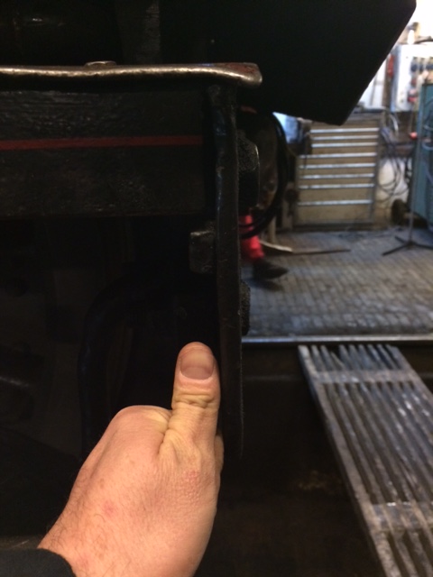

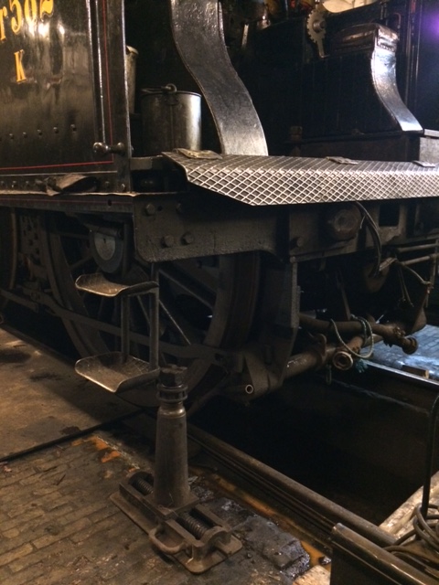

We need to lift this approx 40 ton 4-4-0 (Danish State Railways, Nord Sjælland Veterantog). We can not figure out how to do it without an overhead crane. Where would the lifting points be for screw jacks in a derailment?
Can we lift it on the plate steel buffer plates?
File comment: Thickness of the plate. Can we jack on this?

File comment: Rear of locomotive is most difficult to find jacking points.

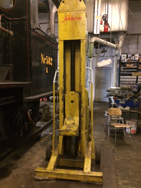

File comment: We have four of these jacks.

Can't answer for a locomotive but I've seen vertical channels on tracked military vehicles (about that thick) fold like a soda can against the rest of the weight pushing on it from above.
I sure wouldn't try it.

Well, just my opinion, but I would not use the bottom edge of that buffer plate as a jacking point.
Regardless of the strength (or lack of) it is not going to be very stable. If that buffer plate starts to bend on one side the whole thing could become over-centered on the jack and come sideways, probably be a bad thing if the wheel is out or part way out when that happens.
Is this an outside frame locomotive ? Is the piece just above your thumb (with the red trim stripe) the frame of the loco ? Or just a running board/cab floor support ?
I would try to get an I beam across under the rear coupler support and try to pick up the frame there with some hardwood blocking.
Or remove the brake rigging hangers and get a jack right under the coupler pocket, but you would need to be away from your pit for that.
Try to avoid tall narrow jacks, the chances of things going wrong get higher. The best jacks will have a base that is several times wider than the height for stability. You can always build up solid wood blocking (with a wide footprint) under a shorter jack. Lift a little, then insert wood blocks, lower the load onto the blocks and reset your jack with blocking underneath it for another lift.
Always a good idea to have blocking ready to fill in the gap between the floor and the item you are lifting for a large lift, the distance to a stop if something goes wrong is less.

I think we have decided against jacking on the rear buffer plate, as it is only about 1/2"-5/8" thick and that would be a lot to ask it to carry roughly 57-60% of the weight of the locomotive!

The buffer plate in the picture is continuous across the back tender buffers and drawbar pocket.
One thought that occurs to me is whether we should weld reinforcement on to this plate and create permanent jacking points here.
What would we do to rerail this engine if a derailment occurred on the line? The national railway does not maintain a wrecking outfit. We operate under a lot of overhead wire, so cranes are problematic. It might be better to be prepared for the need to jack this engine in the future.

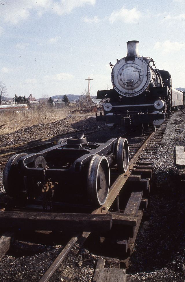

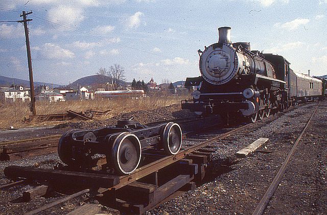

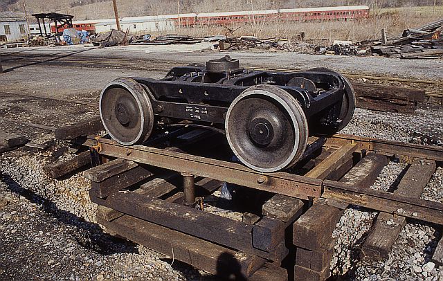

When we rebuilt the Pilot Truck under the #1238, Jack had us cut the rail and dig out for a "backwoods" drop table. We used a pair of air jacks to raise and lower the "table". Maybe no the safest way of doing it but it worked.
