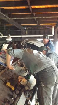

File comment: Richard inside the firebox of the 2100.

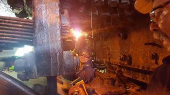

File comment: Stephanie takes a break for the camera while wre wheeling the exterior of the firebox.

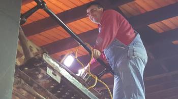

File comment: Jason, Rachel and Gordon are seen working on the fireman's side of the firebox.

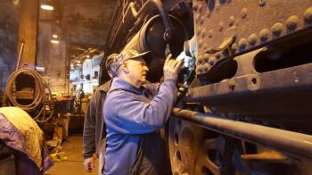

File comment: Here Gordon applies some gentle persuasion to a stubborn washout plug cap. Gordon won.

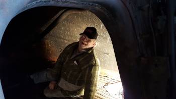

File comment: Gordon and Rick (hidden) inspect a washout seat after lapping.

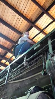

File comment: Brian Tusin takes a break from his work on top of the boiler to flash a smile for the camera.
