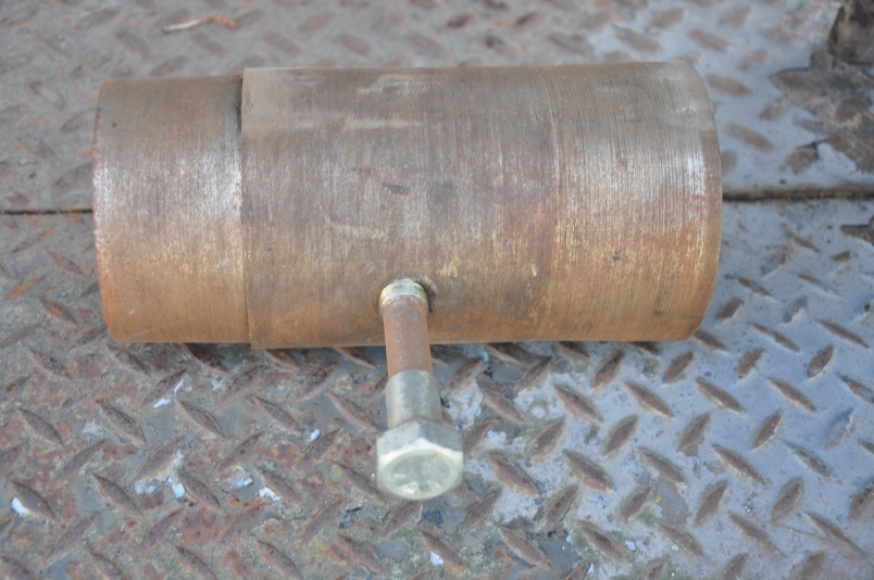

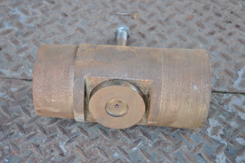

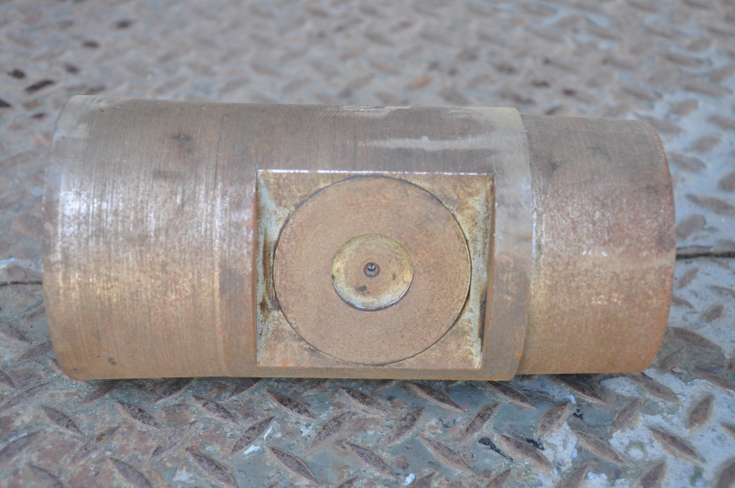

The CTRC group experienced the same problem separating X-SP-2479's cross heads from its piston rods. We tried many of the processes described in earlier posts with no success. One of our concerns was inducing to much heat into the cross head.
Our mechanical adviser remembered seeing an example of a cross head grease press. Images of the press are included. We were careful to ensure that the press would fit both cross heads as they were not the same.
Our first attempt with a light grease failed as it was excreted between the piston and its walls. We switched to material used as journal grease for the main drivers. This worked really well. There was a very loud report when sufficient pressure was applied.
I've included several photos of what the press looks like.
