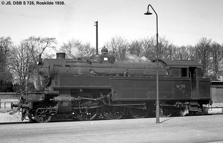

Does anyone know of a locomotive that is or was equipped with rocking grates for a firebox of 3' x 8'? From that does anyone know of any drawings for ones that size?
If I include the pre-designed dump grate, the size comes down to about 6.5' x 3'
This is for a locomotive with a firebox that is in between the frames
