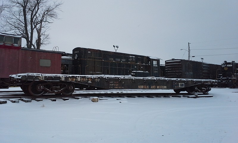

The Bluegrass Railroad Museum has recently received a kind donation, from the Kentucky Utilities Company, of a 1940 built, 55 ton capacity, Norfolk and Western Railway flatcar. It will compliment our N&W GP9 and our N&W plug door boxcar.

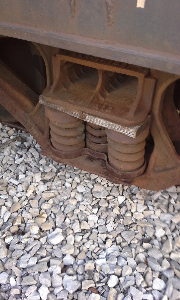

We've noticed some wooden boards within the truck springs. Each set of springs has two or three boards there at the top. Is there a name for these? What is the purpose of them? They appear to be worn out, how urgent is it to replace them?

The wood in there is most likely just a shim to level or raise the car. The coupler height on an empty freight car should be between 32 1/2 and 34 1/2 as measured at the CENTER of the coupler knuckle and ideally there should be 1/4 of side bearing clearance on all four corners of a roller type side bearing. If the design of the truck allows there to be no shim and you can stand to be without them from a coupler height standpoint then you could just remove them. You can also replace them with steel. Once in a blue moon I still see wooden shims in freight car trucks. Most of the time we do not use shims at all. If a car does not sit level without the use of shims then you probably have spring problems or uneven wear problems or a twisted frame. You can also shim in the center plate to gain coupler height if you can maintain center plate engagement.

Greetings:
A pretty common repair.
I would suggest replacing them with new white oak, cut to the same size as the originals or thicker if the coupler height of the car is too low as mentioned above.
Steel could be used, but: 1) it would not be an "authentic" repair for your car (obviously), 2) the steel would have to be secured somehow to keep it in place (the wood would not) and 3) steel is more expensive than white oak and not as easily modified to fit.
Good luck!
J.David

What is that round feature midway along the length of the board? Is that the end of a steel tie rod that passes through multiple boards?
It looks like there is separating joint there in the wood, but I cannot tell if that is what it is for sure.
Is it only the friction of the car weight squeezing on the wood that keeps it in place?

Can't comment about what looks to be a saw cut, but it appears that the wood shim is H shaped; look at the near corner and you'll see it is wider than the slot the slot in the sideframe the bolster rides in. I suspect the rusty thing in the middle is a long rivet to keep the wood from splitting and falling out.
Come to think of it, I don't think I've ever seen shims inserted with the grain parallel to the rails; they normally show the end grain to the outside of the truck. In that orientation a split shim could be contained by the sideframe, and would have to move an awful long way to fall out.
I'd just jack the truck and inspect the shim for rot. If OK, just slop some oil on it for additional waterproofing. If decay has set in, replace in kind, using white oak.

I went out to the RRM of PA today for a look see. I did notice several wheel sets with wood blocking on freight cars and some lone trucks. Interesting that the wood blocks were for the most part "grain out" and a close look at one wheel set showed some type of "cut" to fit the springs as well as a keeper.
What Dennis said. I've replaced and installed dozens of these.
