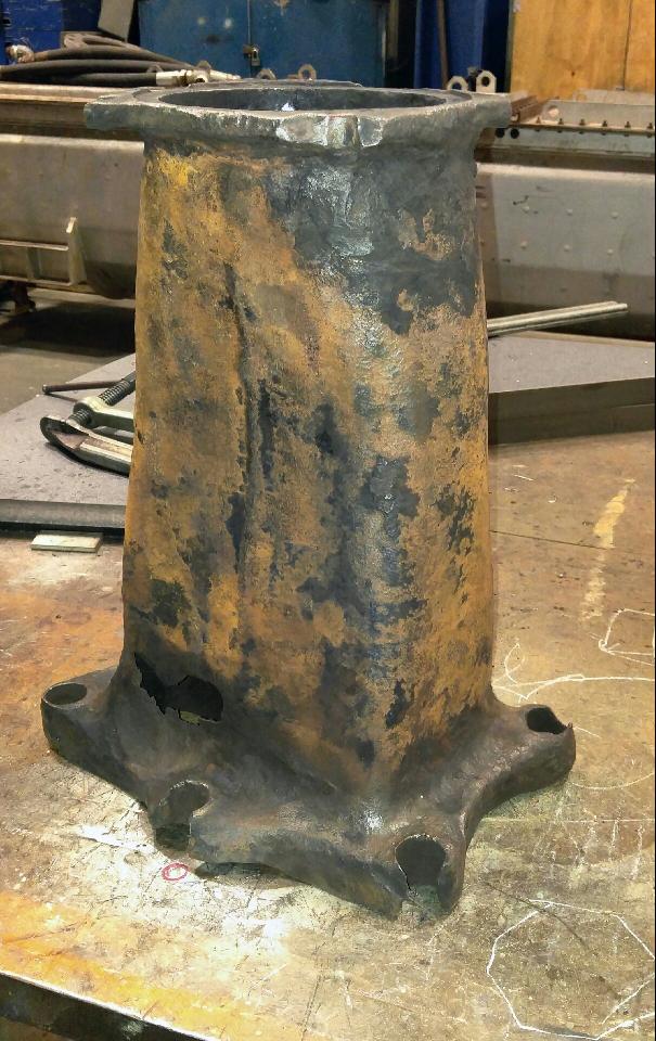

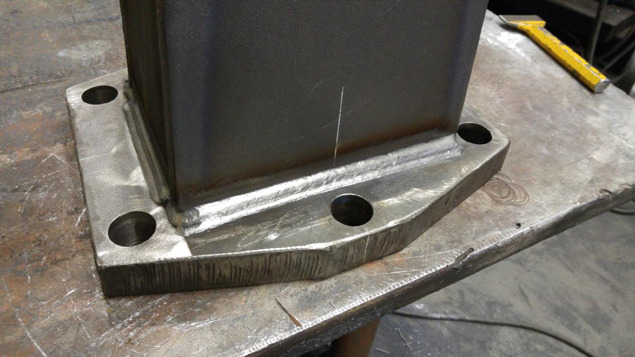

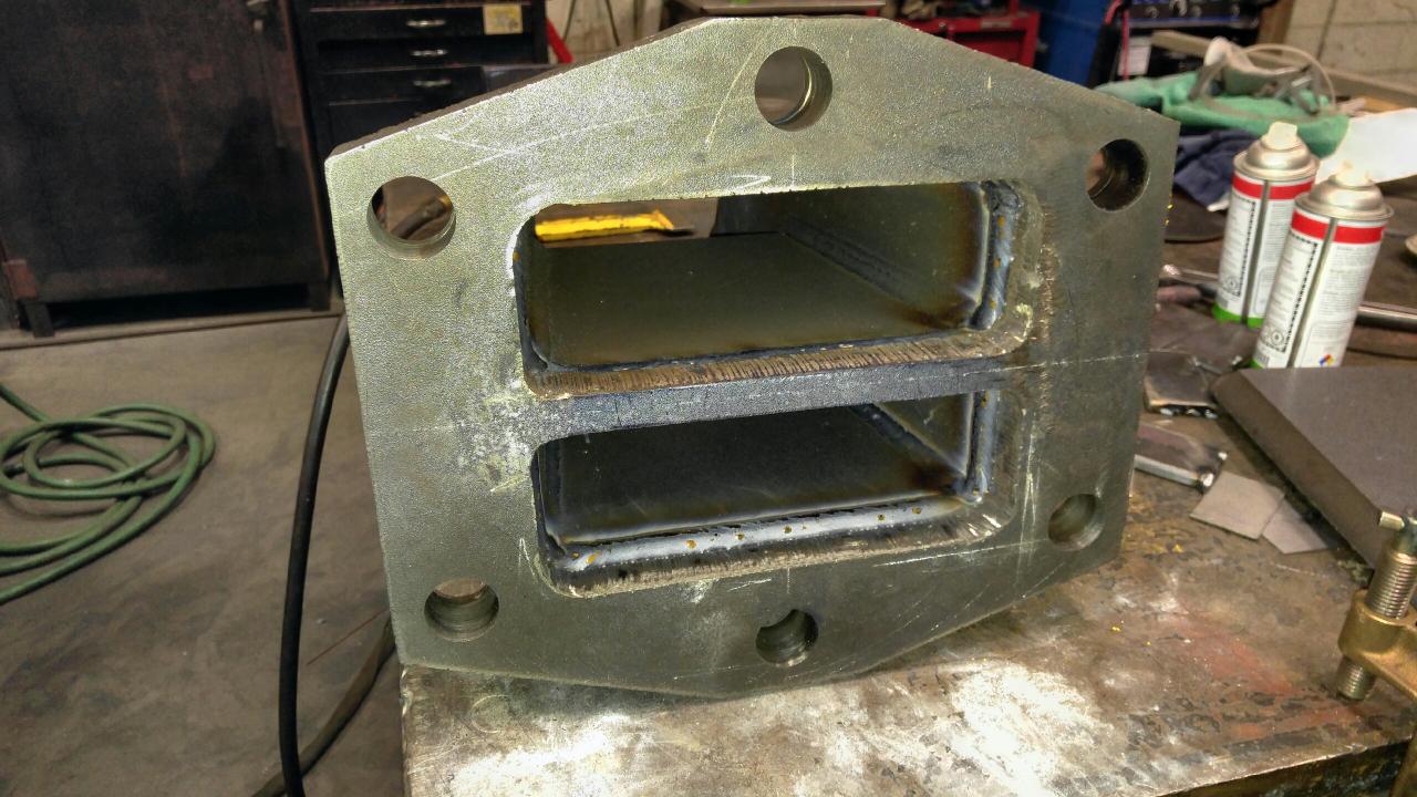

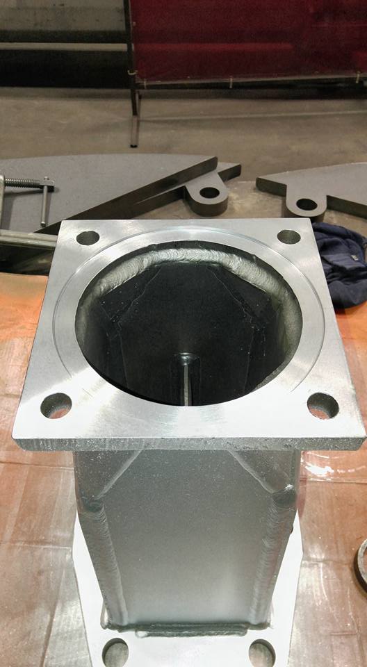

After 106 years engine No. 98's blast pipe has reached the end of the line. The original was cast. Making a pattern and casting a new one is very costly so we chose to fabricate a new one. The new one is beefy enough that it should last another 106 years.
Blast Pipe-3 Engine 98 Jason Oreilly Photo 2015-01-10.jpg [ 79.38 KiB | Viewed 11340 times ]

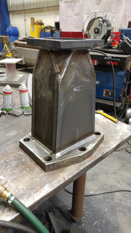

Yes, there is a splitter in the middle. It is of the same dimension as what the folks at American Locomotive Co. installed in 1909. I didn't do any of this work. Our hard-working and talented CMO coaxed all of the steam pipes out of the front end without breaking anything and a local boilermaker has done the fab work at a very reasonable cost.
Blast Pipe-1 Engine 98 Jason Oreilly Photo 2015-01-10.jpg [ 143.13 KiB | Viewed 10946 times ]
Blast Pipe-2 Engine 98 Jason Oreilly Photo 2015-01-10.jpg [ 125.58 KiB | Viewed 10946 times ]

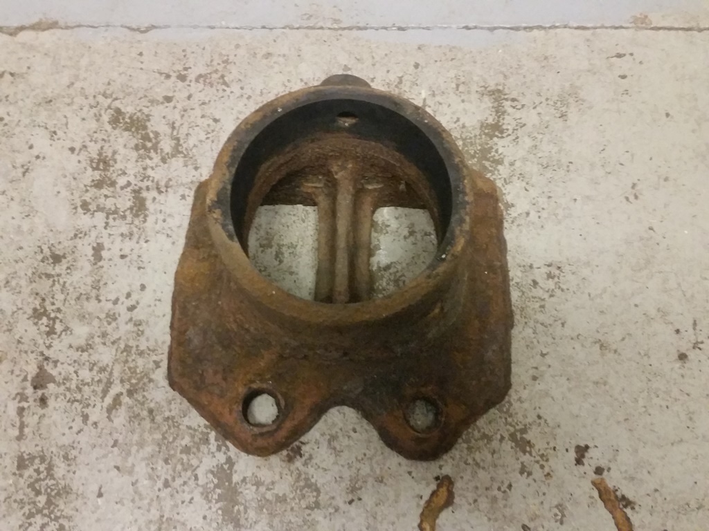

I am looking at fabricating a new blast pipe for the J&L 58. It is much shorter in height, but displays the same erosion and corrosion that the 98's old pipe has.
My approach is going to be a bit different. The new blast pipe will be a series of 1 1/4" burnouts stacked on top of each other, with the interior passages milled to the correct taper on each burnout. The stack of burnouts will then be welded together forming the new blast pipe. I looked at fabricating the new one similar to the way 98's pipe is made, but its so small that I would be trying to piece together a lot of very small pieces and its not easy welding on the interior of such a small space. I haven't yet ordered the burnouts as we are several months away from needing the blast pipe, but its all drawn up in CAD and ready to go.

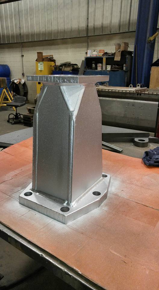

Here are a couple more of the finished product. The TEE in the steam delivery pipe is being fabricated next. More to follow.

Posts: 1326
Location: Pacific, MO
I'm not sure what, but would the weld bead inside have any effect?
1522 always had sort of a "chirp" when running with a light exhaust. We never did figure out what caused it unless it was a cavity in the exhaust passages in the cylinders.
