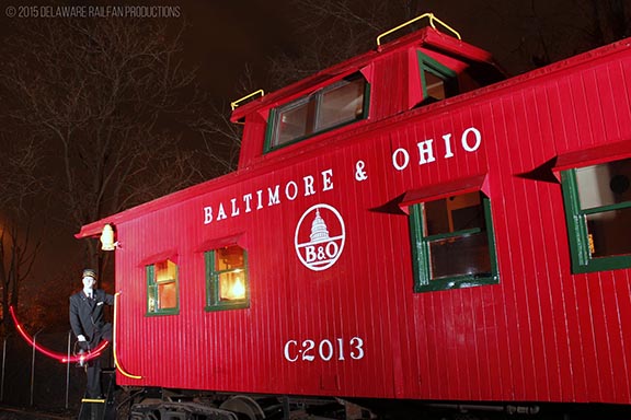

I'm trying to come up with a heating system for Wilmington & Western's B&O I5d caboose C-2013. Presently we have nothing. I'm interested in finding out what people have used recently to provide caboose heat. We're staying away from coal stoves due to the dirt and extra work associated with coal and ash. our other two cabooses have kerosene stoves to kerosene would be ideal. Can anyone point me towards something or possibly have a stove for donation, trade, or sale?

Good concept, except the 2013 doesn't have a stove in it. For many years, it was the " Summer Caboose"for this very reason and the C-2042 was the "winter caboose" since it still retained its stove.
So they first need to get a stove....or some form of heat.
