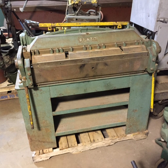

I'd like to give my little Pexto finger brake a new paint job. What is the recommendation for the best brand and color of paint for proper Pexto green? Or for green painted machine tools in general? The commercial Krylon or Rustoleum Safety Green colors are close, but too bright or not the right tint......I'd be interested to know what others have used in painting their machine tools.......

Try Valspar Tractor and Implement color line. Oliver green might be nice choice. A little duller then John Deer green.
I used both spray bomb and quarts. They offer a hardener too for the quarts/gallons.
http://www.valsparmro.com/products/Specialty/Tractor-Implement-Spray.html
Scott

"Sea Foam Green" (I'm not kidding) is just about a perfect match. Also used by some roads as a diesel cab interior color. You might have to get a clean sample and have it matched. Try a Benj Moore commercial store or distributor, and get the P22 series urethane enamel, easily matched and custom mixed. I pay about $32/gallon for the stuff, and as Scott says, you can add some hardener. It sprays and brushes out really well.

Gack! Sea Foam Green (also Focal Green or Postal Green) are modern colors, from the fifties, sixties maybe. I'd go with the Oliver green for the traditional look.
There were woodworking machines built under the Oliver name, but I believe it was a different firm. They were also dark green.

Is there any small part with paint in good shape, that could be taken to an auto parts or paint store and scanned to match?

Of course other discussions on this board mention paint research and matching. I would not be hard to identify and sand out a example of the original paint found on the machine (find a cover or similar which is portable), then have that matched in modern automotive paint by a dealer... (they can do spray cans) This would be defensible as "most accurate"
Alternatively find a color you like... look at tractor colors, then use that. As others have noted there were many colors used, and machines were repainted when overhauled. So you can choose a color for "your" shop... it is after all yours...

I now realize that the OP wants to restore his finger brake, so of course matching to a clean color sample on a removable part of the machine is the way to go, although I'll admit, restoring shop machinery is a concept that is rather foreign to me. I typically just pick a color that's close when something needs paint.
