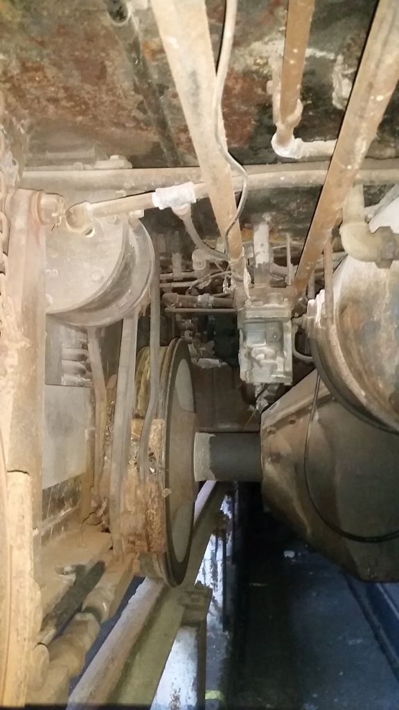

Ok, so, a question for the GE 25ton operators on here. Did the mechanical inspection on Saturday on our GE. overall it's pretty good, but we were told that they took an air tank out and replaced it with just a piece of pipe after the tank rotted out. So we know where the tank was and need to know what size tank was there, and what it looked like, etc. Our unit is 1948, so if anyone can provide more info, it would be very much appreciated.

I'd be worried about this cheap fix. With no air storage, once the engine stops or is shut down you have enough air for MAYBE one application. You want to consider a replacement air tank pronto. And make sure it's been hydro tested.

Ummm yeah, kind of aware of that, hence the reason for the post. We don't move much around, and it's not switching and or running constantly. It would likely be fine without it, but we would rather just reinstall another tank. The post is to ask anyone who owns a 25tonner what size tank they have so we can source out a replacement. It's out of service for the winter, so we want to get the new tank installed before spring.

The 2 tanks under our 25 ton with the 14EL brakes are fairly large, I would say something like 12-16 inch diameter and 4 feet long. The brackets and pipe I see there sugguest you have a MUCH smaller tank. Maybe something like this would work?

The main air tank Is located between the 2 axles in the centre. There isn't anything in the manual as to size of the air tanks, so kind of hoping someone else would know. It's likely not as long as the piece of pipe as there has to be space for the fittings. Diameter I would say is 12-16", as I think someone else mentioned. Hopefully we can find a replacement that's not too costly.

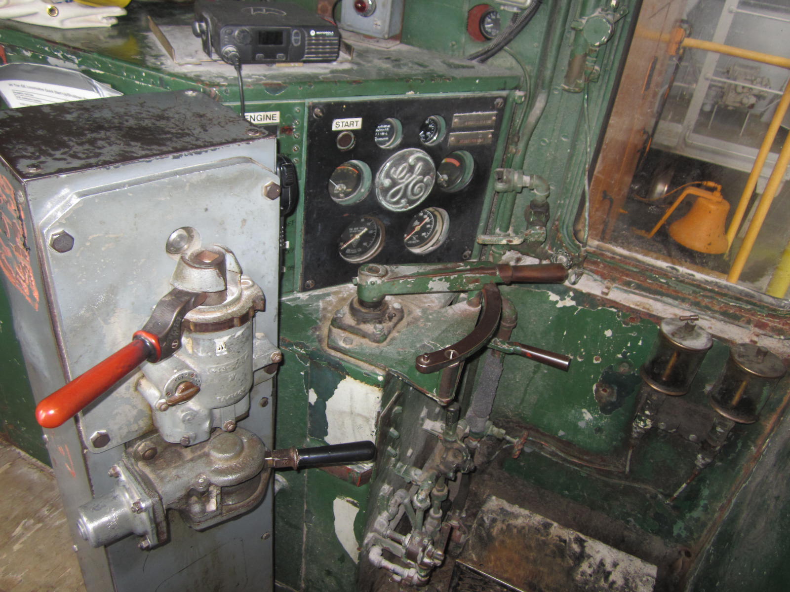

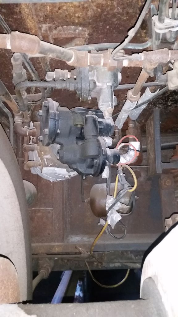

The brake system has been upgraded over the years, and is now equipped with train air. 2 more pics, one inside the cab of the new brake stand, and one of the control valves underneath. The reason it was straight piped was because the tank rotted out. Replacing the unit with a new Titan Trackmobile is what led to the decision to scrap the unit. Thankfully an employee had been to our site and contacted us, and the plant manager to see if it could be donated to a museum rather than scrapped. For us, it was a HUGE win!! Yes, it took almost 8months, but I guess good things do come to those who wait!!

Just going by the photos, it looks like you have 26-NL, which is a simple system using a 26 brake stand and a 6 distributing valve, both pictured. There is also an H type relay valve that provides bailoff or actuating, again shown near the distributing valve. I'm assuming you are looking for a main reservoir? The only other reservoir, in the most simple form of this system, is the equalizing reservoir, which should be 220 cubic inches, which is also in the picture, painted black. Hope this helps-
Edited- just took another look at the images and saw the eq reservoir. Still say it's 26-NL, though.

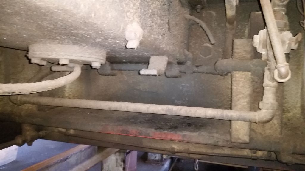

I can get a better pic when i'm out there on the 24th, but you can see the current main air tank (sort of) at the right of the pic.

If you still have 1 air tank, I think I'd quit worrying about it, for now. Probably won't ever deplete the tank you still have. On ours, both tanks are identical. What I WOULD worry about is maybe closely checking this tank to make sure it's not about to fail!
