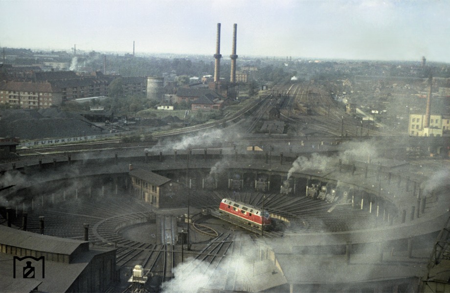

Battling turn tables comes to mind.

That's got to be in Germany. Since the German mindset is wait for orders from headquarters, it worked just fine. Not so sure it would work here.
 Post subject: Re: Is there satisfaction in gimickry?
PostPosted: Mon Dec 21, 2015 5:19 pm
My question is are both tables interlocked in some way to keep one from swinging into the other at the point where their paths cross??

I did a Google search on this and came up with http://www.marklin-users.net/forum/yaf_postst8978_Double-turntable-in-Hamburg.aspx. Unfortunately, the posts are rather old, and at least some of the links are dead. Nevertheless, there is some interesting stuff posted there.

"On the other hand, two turntables with the circumferences of their pits intersecting each other (German: Doppeldrehscheiben) was uncommon. There were only two of them in Germany, at Bw Hamburg-Altona and at Bw Köln Betriebsbahnhof. Originally, turntables at these two loco sheds were not Doppeldrehscheibe. These sheds had two turntables that were close (touching) to each other. The roundhouses for these turntables connected to each other at one end. During the 1920s there was a need for longer turntables to accommodate larger locomotives. At Altona and Köln it was impossible to install two new turntables side by side, or even one new turntable in the middle without realignment of the tracks leading to the roundhouses (which I suspect would have led to the rebuilding of the roundhouses as well). Therefore, the DRG chose to build two turntables intersecting each other at these two sites (you may say as a compromise or as a lesser of the two evils) instead."

I'm curious what the frogs looked like where the two ring rails intersected.
PostPosted: Mon Dec 21, 2015 7:05 pm
Posts: 343
Maybe nothing at all if there were no flanges on the turntable wheels. Might have just been that the rails were closely cut to fit right against each other

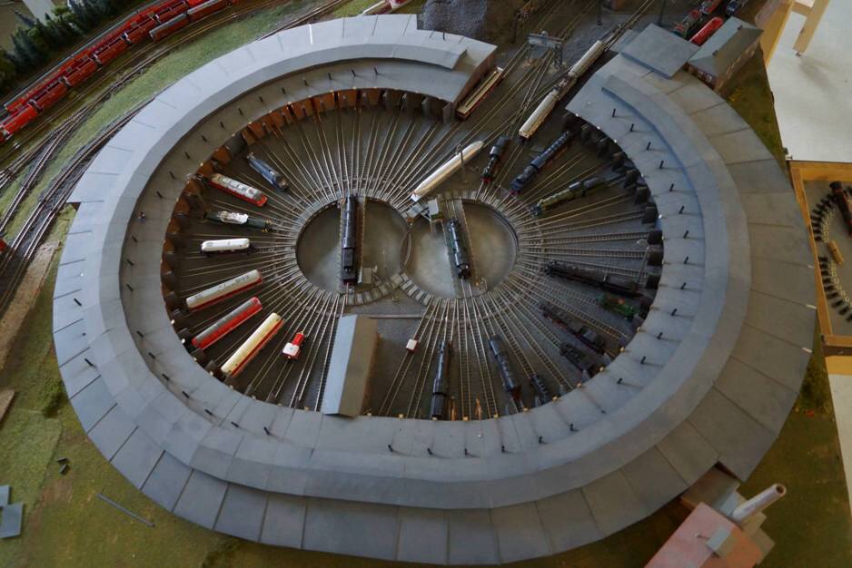

Thought this might be of interest to the model railroaders out there.
Here is the Hamburg-Altona roundhouses in model form, I'm not sure of gauge.
File comment: Model of Hamburg-Altona twin roundhouses in Germany.

The double table roundhouse in Hamburg is long gone, but you can still see the foundations when arriving to the end of the line, Altona, by train. The land has been partially used to realign the high speed and s-bahn mains.
The two tables can still do a lot of work without conflicting each other, so there is some productivity improvement with the two tables.
