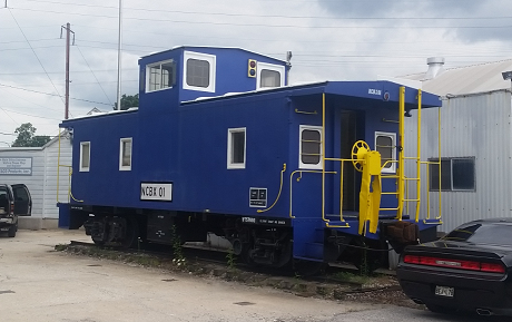

The Friends of the Stewartstown Railroad ( I am a member) has started a GoFundMe drive to get a caboose moved from an industrial park in Baltimore to Stewartstown Station.
Former UP 25623, it was given to an executive at Waco Products in Baltimore, but needs to leave.
We tried to get it moved by rail to our location- cleared with NS, brakes to spec, UMLER ID, had the sidings for pick up and drop off selected, etc. but one of the connecting railroads ( I won't say which) put the kibosh on those plans. So, we need to cut the cupola off, truck it down, and reassemble.
We'd appreciate any help in getting this caboose away from the scrappers and back to running on our railroad.
Thanks in advance
http://www.gofundme.com/8r6ec6x68

I know precisely where the car is--in fact, I *think* that's MY photograph they used in the post. Unless the same car parks there all the time......
It's going to be problematic no matter how it's done. Note the PRR catenary pole in the background. This is hard up against the Northeast Corridor. It's going to be enough of a pain to truck it out of that location that I can see why they'd entertain rail movement. There exists a siding about a thousand feet north of this car's location, but it'll still have to be trucked over to that location from where it is now, so.......
Alex -
I took that pic two weeks ago as we were dismantling the interior of the cupola, so the car must always park there.

Mike, what is your lowest immovable obstacle (not counting wire drops that can be slid over the load? Are they bridges, etc., or wires?
Your car does have a tall cupola, could be a tough move in some areas in the northeast. How tall is the car (both with and without the cupola)?
Depending on individual utilities, or even regions of individual utilities, you might get a concession on wire raising fees.
Late in 2010, we moved CNR snowplow #55400 by road from Ottawa to Smiths Falls, Ontario. Even using a low railway bed float with the car off its trucks, the horn and headlight removed, the load came out to 16'9".
We, too, had been resigned to removing the cupola but that proved unnecessary. A week of exploration revealed a very roundabout route where the only overhead obstacles were wires. This was complicated by one sharp vertical curve in an otherwise suitable road- the float would have hung up there.
In the route we chose, the worst wires- those taut, thick main telephone lines- had a bit of slack coiled up at intersections, which enabled raising them.
Quite a few wires were raised by several utilities- Ottawa Hydro, Ontario Hydro (through two separate regions), Bell Telephone, and a couple of cable TV companies. Of all these utilities, the only fee we paid was to one office of Ontario Hydro- the corporation's bean counters overturned the donation of the work on the last day, after the line crews had already spent two days preparing.

While we're still raising funds, the Blue Caboose will arrive via truck in Stewartstown on Thursday, August 13th.

Cupola is cut, and on August 11th will be removed, along with wheelsets and assorted hardware, and loaded onto trucks.
On August 13th, at Stewartstown Station, the whole caboodle will be reassembled.

I know pretty well the locations where this caboose will have to be removed from, and moved to.
Yeah, that cupola had to come off. <:-/
