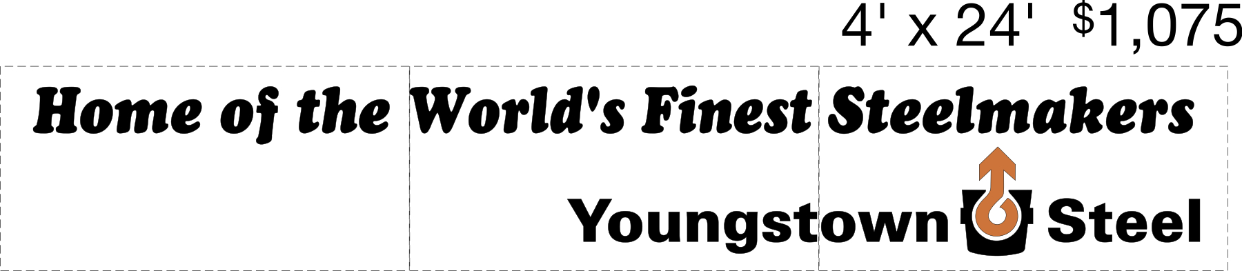

Magnetic signs do not necessarily mean magnetic sheets. I have had signs made of a material that is basically two thin sheets of aluminum around a core of plastic. I attached magnets to each corner, or as many are needed, and affixed that to our equipment. The latest ones are 24" x 36" in size and are scans of pages from a 1915 issue of "The Engineer".
The signs are inexpensive enough that if one gets destroyed or damaged it can be replaced without impacting the budget too much, and the professional quality of the signs really makes a huge impact on visitors. They last a long time, we have had some out there in the direct sunlight for going on 4 years and they still look good.
I would recommend that all of the signage match, and it would be great if the signs all featured either the museum's logo or at least matches the museum's graphic design standards. This very simple trick makes a huge impact.
Every museum should be on a first name basis with their local sign shop.
The image is of a three part sign that I had made up to go on the back wall in the Tod Engine House. It is a recreation of a sign that was made for Youngstown Sheet & Tube. I scanned the original, converted it to PDF and she simply printed it out and applied it to the aluminum core board. Yes that is what it cost to have made.
