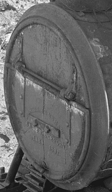

One of these odd locos has been identified. My friend over at www.gearsteam.com has found that the Hobo was built by Miller & Shaw. See:
http://www.gearedsteam.com/other/images ... 20&%20shaw).jpg
Here is an article about this obscure builder.
http://www.gearedsteam.com/other/articl ... rticle.jpg

Here is the complete link for the photo:
http://www.gearedsteam.com/other/images/moulton_&_o'mahoney-hobo-10-12-1900-smokebox-%28miller%20&%20shaw%29.jpg
John T wrote:
One of these odd locos has been identified. My friend over at http://www.gearsteam.com has found that the Hobo was built by Miller & Shaw. See:
