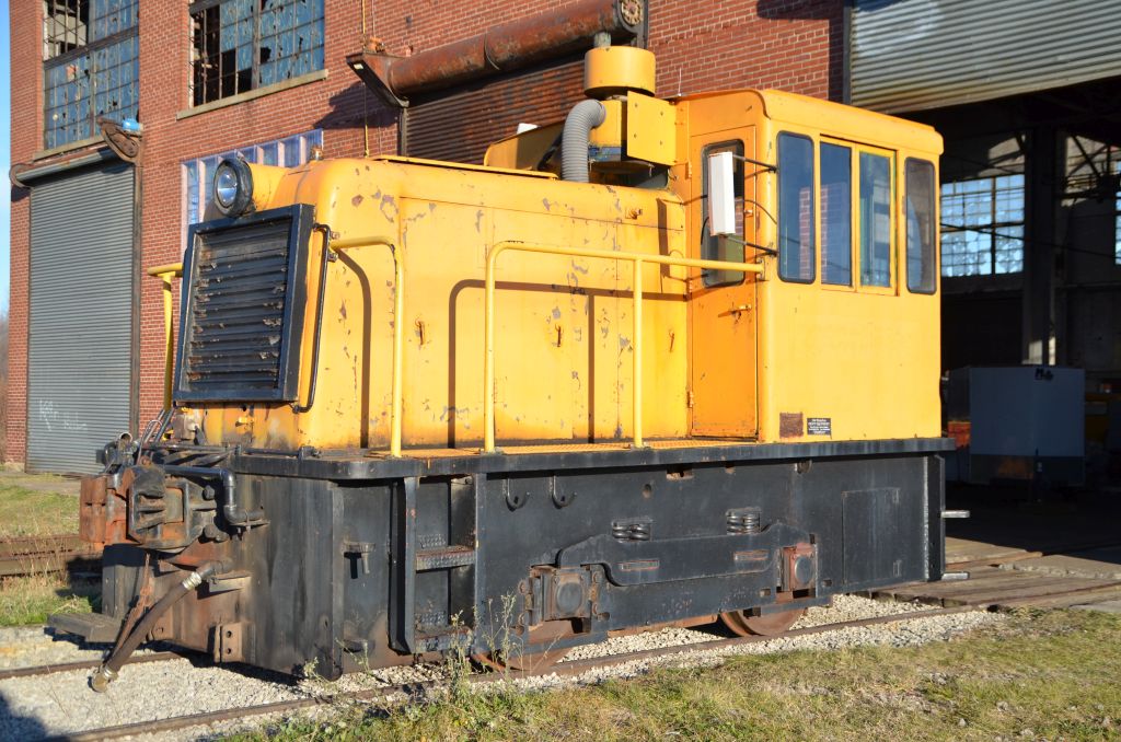

On November 30th, the Niagara Railway Museum Inc. moved its newest acquisition, a 1948 GE 25 ton diesel from the former BF Goodrich plant in Thorold to our site at the CNR diesel shop in Fort Erie. The locomotive is in operating condition and was driven onto and off of the float. It will come in very handy at the shop and was the first locomotive to fire up and move inside the shop since the late 1980's. The entire story, with pics and the video link can be found at http://www.nfrm.ca/blog

BTW, what is the contraption around the exhaust stack?
 Post subject: Re: New locomotive
PostPosted: Wed Dec 02, 2015 4:59 pm
Posts: 243

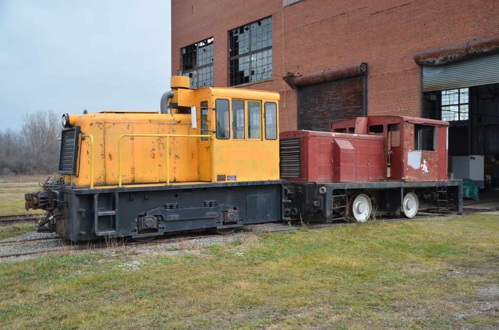

David. I believe it is an air filter system. Obviously a bit of a modification. I hooked the bell back up today, just had to replace the air line. I am however having a bit of an issue. It keeps wanting to load as soon as you put it into forward or reverse. when ya knock the brake off it starts moving. And I haven't even touched the throttle yet. When I pull the throttle out, it picks up so fast the wheels start spinning. I need to keep some brake on to control the wheel spin. Seems to me that's NOT a normal thing. Anyone with any thoughts on that??
Today I decided to pull our Plymouth MDT40t outside and get a pic with the 2 of them together.

Yes sir Ken, the throttle reaction of your GE is not normal! The way PTM's similar GE is set up releasing the brakes with the throttle just open enough to pick up the motoring contactor will cause the loco to just barely creep on level track. At that point the engine speed is still at idle. If yours is moving with the throttle still in the idle notch (locked there until the button on the lever is pushed) then you may also have a wiring issue. Sounds to me like there's been some tinkering done by those not necessarily knowledgeable in the control system. You may want to start by tracing out the wiring against a GE schematic.
PostPosted: Thu Dec 03, 2015 10:15 am
Posts: 1043
Location: NJ
I would take a look at the throttle switch. There should be a switch on the throttle that closes and pulls in a contactor or exciter relay when the throttle is opened. If that switch is either stuck closed (making contact) or has been bypassed, you will get power as soon as the reverser is shifted into FO or RE. I don't have a wiring diagram, but they are all about the same in that area.
PostPosted: Thu Dec 03, 2015 2:44 pm
Posts: 705
With the throttle at ldle, NOTHING SHOULD HAPPEN when you shift the reverser into forward or reverse. That alone points at the stuck throttle switch mentioned, or other possible glitches. In an event, DO NOT allow current to flow in the traction motor when the loco is standing still. This will cook commutator segments in short order, and the fix will be very expensive.
Your symptoms also suggest that engine rpm is set way too high. It should be nearly impossible to spin the wheels of this loco on dry rail.
