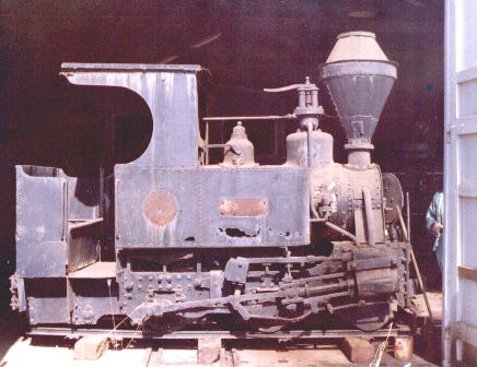

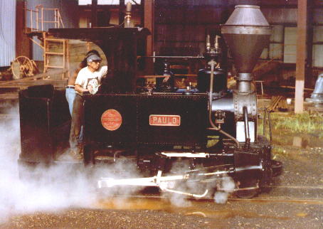

Some of the best kept secrets in the Loco Restoration Field.
"Everybody" said they would never run again.
Grove Farm Museum PAULO.
1887 Hohenzollern retired 1920. Displayed in Koloa Town until 1970s.
Reboilered in 1981. I took a semester off from college to manage this 6 month restoration project with 5 guys on the payroll. PAULO still runs at least once a month for the Museum run days.

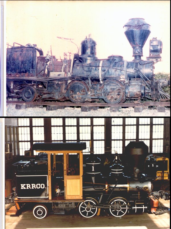

Kahului Rail Road #1 "Claus Spreckles".
1882 Baldwin retired 1929. Donated to Bishop Museum in Honolulu 1966. Tree fell on it.
Returned to Maui 1985 and restored in the original KRR shops using the original machine tools. We spent 4 months restoring the shop machinery before starting the loco restoration. It was cheaper than contracting out the machine work. I designed and built the boiler in the shop. We had a crew of 4 over about 20 months.

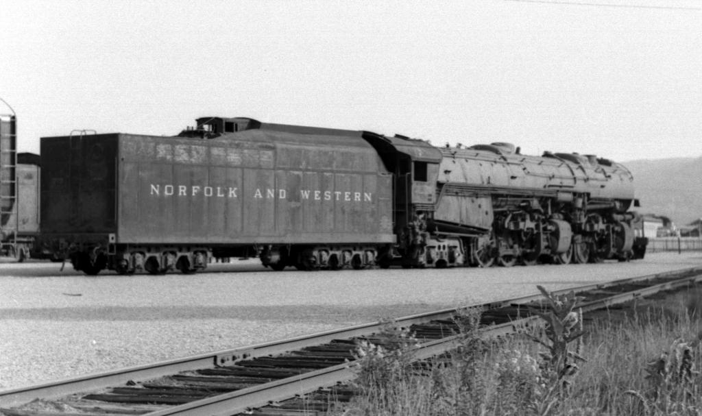

I remember when N&W # 1218 first arrived in Vermont at the old Steamtown , all she was, was a mass of rust . On the tender in letters was Do Not Scrap , I said the same thing she will never run again . Also if you want add the Climax that is getting restored at Cass Scenic RR .
Yes they are some locomotives , that are in museums and parks , that would take a pile of money to restore . Another example is the Maine Central # 470 , the last time I saw her , she was just a pile of rust and neglect .
Now Thanks to the New England Steam Corporation , this locomotive will someday in the near future Steam again .
File comment: N&W # 1218 in Vermont
