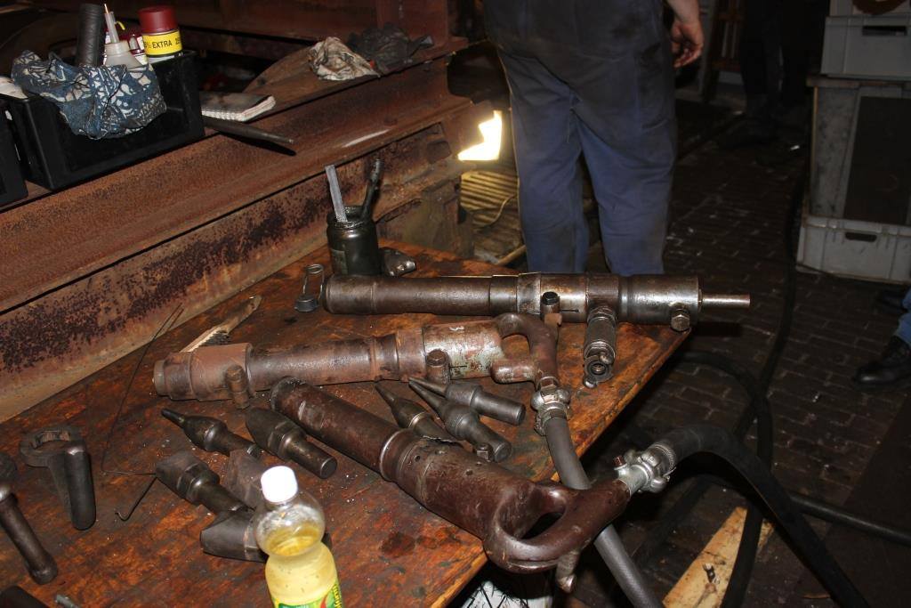

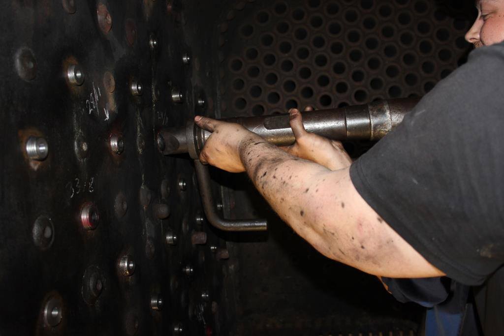

The interesting part of the whole ordeal comes in sealing the boiler. The tapered cone bore in either end is for the purpose of expanding the material to fill the threads completely. Two medium sized air guns with expanding tools are operated by two guys, with a third person measuring the distance from the sheet to the stay bolt head inside the firebox. This is so there is enough material to be moved and form a round head (similar to rivets). The tool for this purpose is a large air gun with a second piston on the back to help lock the gun in place. One man opens the air valve, while another turns a handle on the forming tool to help achieve the round head. Finally when all of this is done, the process is complete!

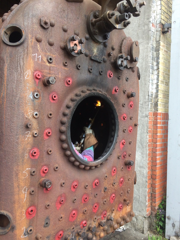

File comment: burning out stays

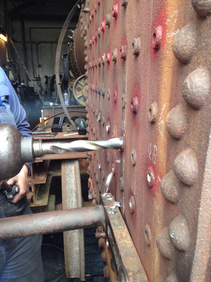

File comment: drilling out the other half
11230105_10206116311900309_2038132432992160402_n.jpg [ 109.79 KiB | Viewed 5932 times ]

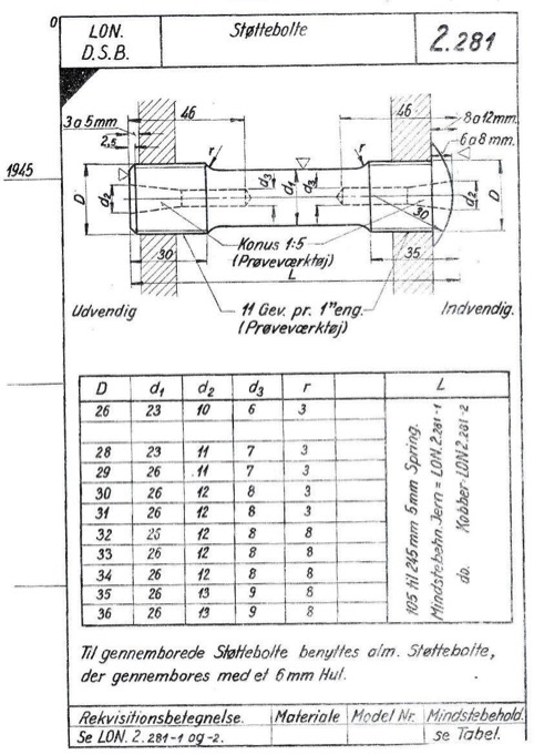

File comment: The drawing all stay bolts are machined too

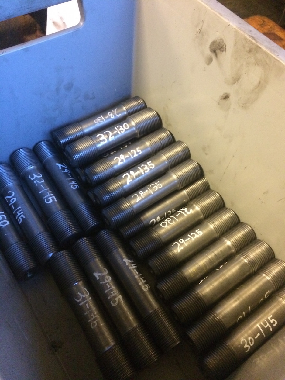

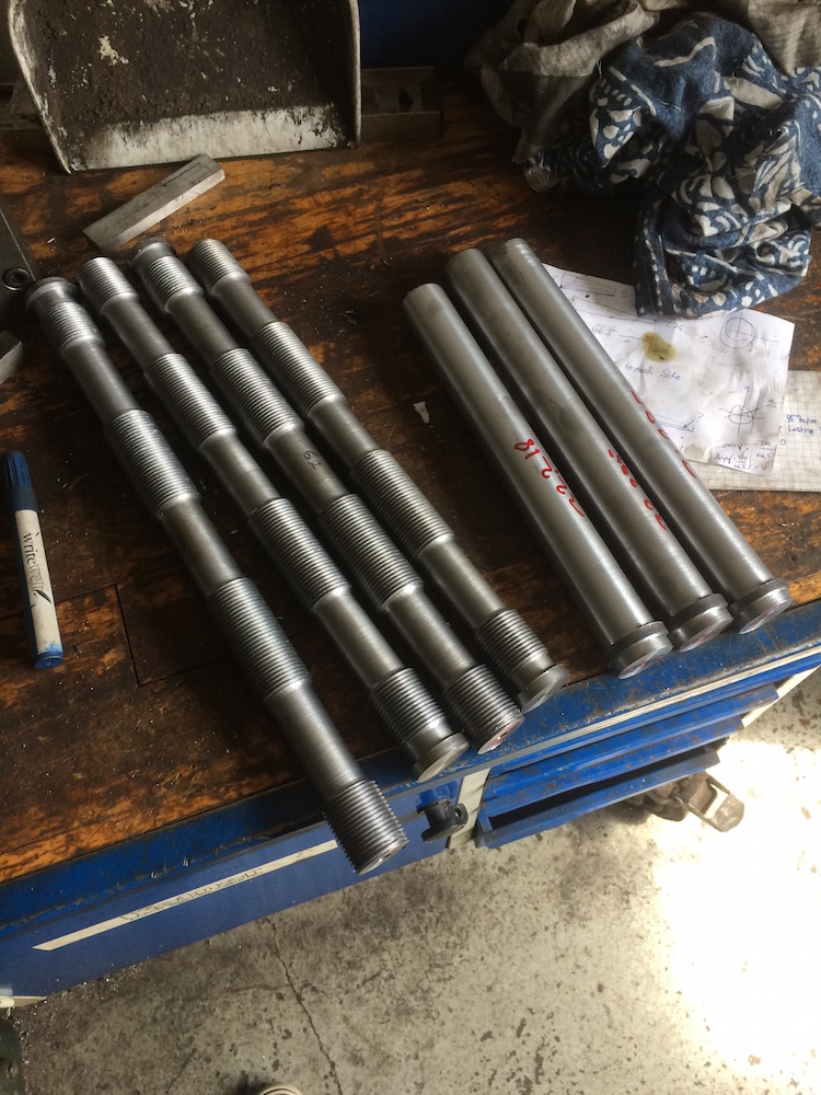

File comment: blank rods before threading and threaded rods together

File comment: the two types of air guns and various expanding tools
11232964_10204651301299310_4289279142071641970_o.jpg [ 92.41 KiB | Viewed 5928 times ]

forming the heads:
https://www.youtube.com/watch?v=k9paM7Q ... e=youtu.be
File comment: forming the heads inside the firebox
11894595_10204651302699345_7561793306770397598_o.jpg [ 52.95 KiB | Viewed 5919 times ]

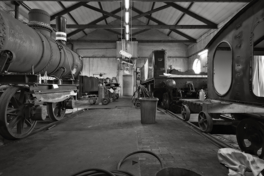

File comment: a moment of peace at the end of the day
