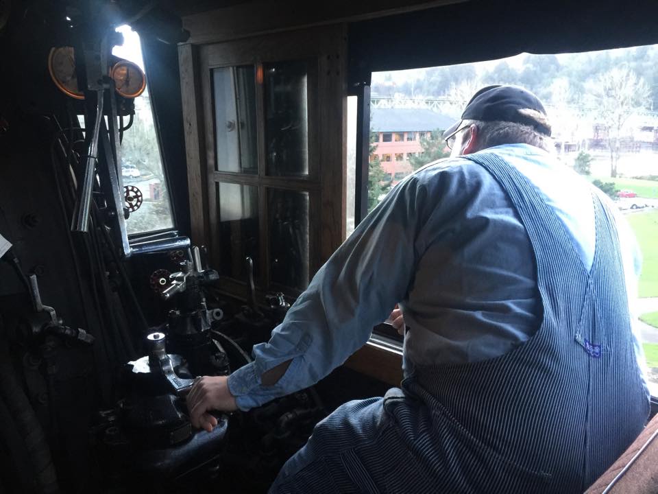

A drifting throttle, in my experience, is basically a much lower volume throttle that can be dialed in much more accurately at lower settings than the main throttle. It also usually delivers saturated steam instead of superheated, which carries steam oil much more readily than superheated steam. In the photo here of me running SP&S 700, the drifting throttle handle can be seen right next to the main throttle handle. This one I believe is no longer attached internally, however I've seen it used in the past.
Scott Gordon
10847921_10203356568820330_2632119505382510968_n.jpg [ 78.46 KiB | Viewed 6893 times ]

Extremely similar to the 4 Aces setup. Thanks for the pic!
