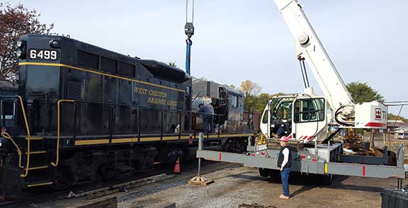

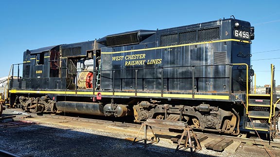

Here are couple of photos of the generator installation. Photos by Ann Gillaspy-McHugh.

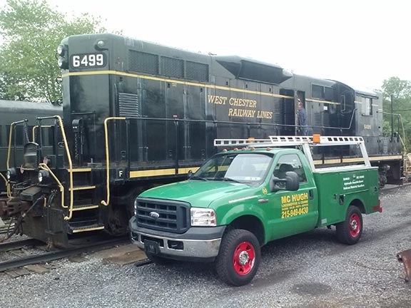

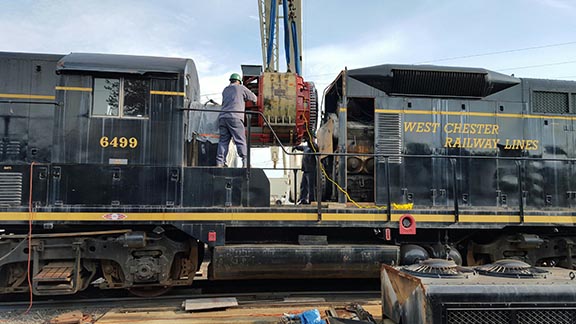

Here are a couple of more photos.
