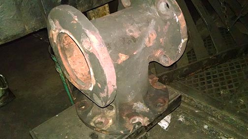

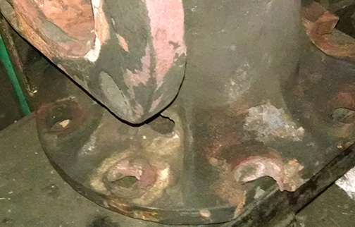

After 106 years the tee in No. 98's steam delivery pipe system sprung a leak. The amazing folks in our shop worked really hard to remove the pipes and we hired a contractor to fabricate a new tee. Once we got a good look at everything we decided to go ahead and replace her steam delivery pipes as well. You can see the hole in this photo.

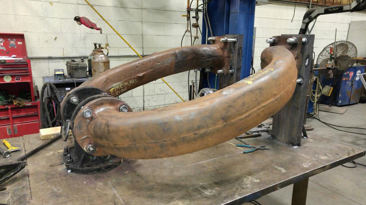

Once the pipes were out they were fitted back together to replicate how the new pipes needed to attach.

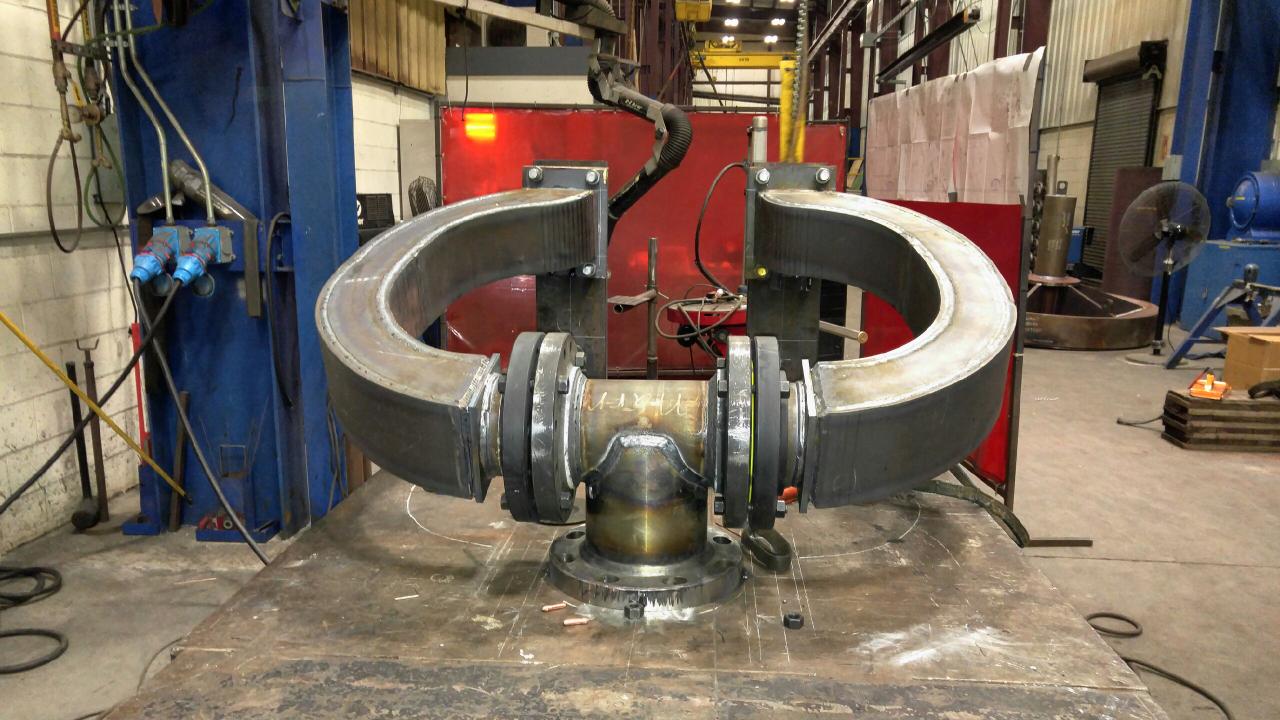

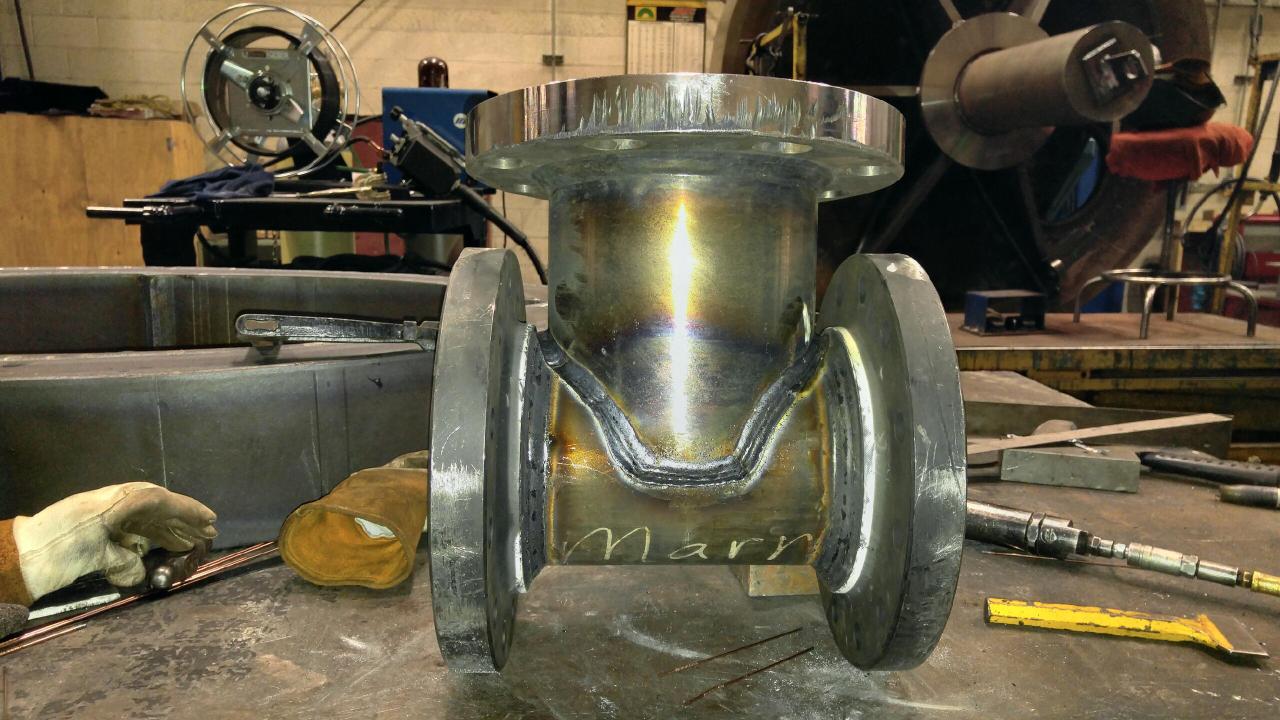

A new tee was fabricated.

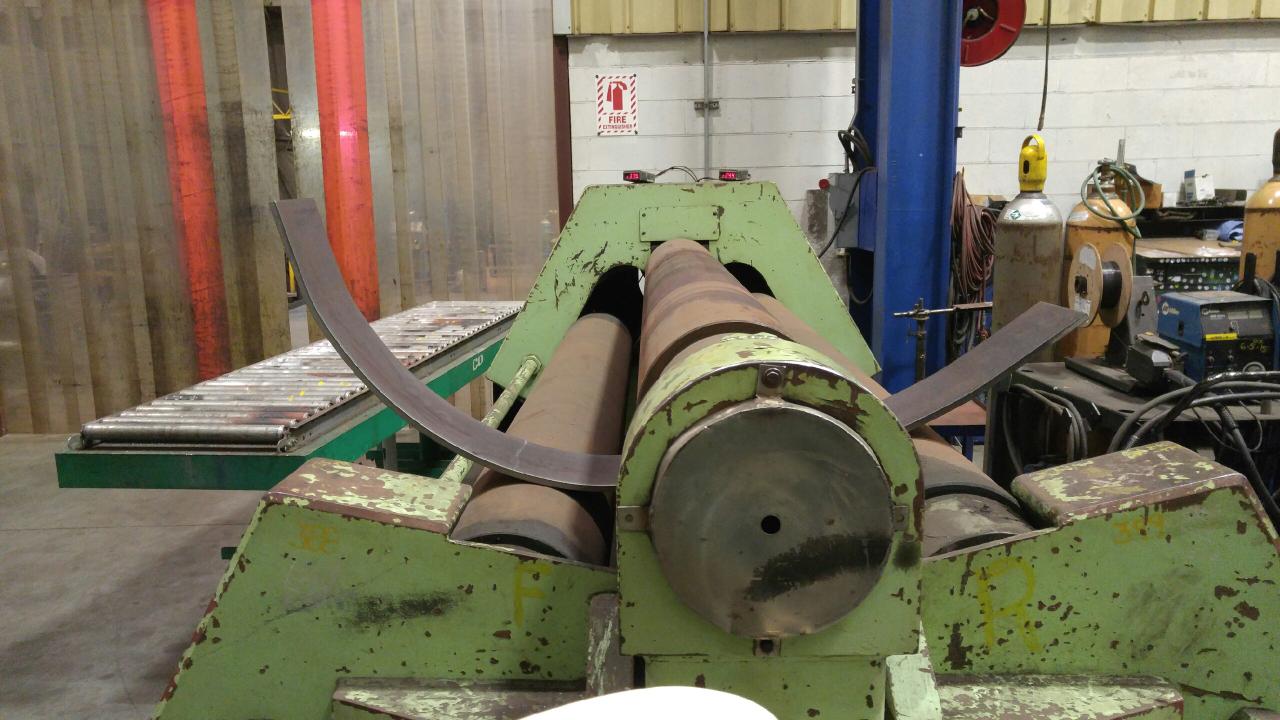

Boiler plate for the steam delivery pipes was rolled and bent into the right shapes.
WWRR 98 Steam Pipes Metal Being Shaped 2016-01-24.jpg [ 125.38 KiB | Viewed 7973 times ]
The fabricated pipes were fitted to the contact points created earlier with the old pipes.

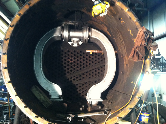

The tee and pipes were installed with the top flanges on the steam delivery pipes loose.
The flanges were tacked into place. Our next step is to remove the steam delivery pipes and weld out the flanges and then install everything for the final fitting. The tee will remain in place. More to come. Nobody is ready to take a victory lap just yet but it is getting close. I can't thank our CMO Steve J. and his crew enough.
