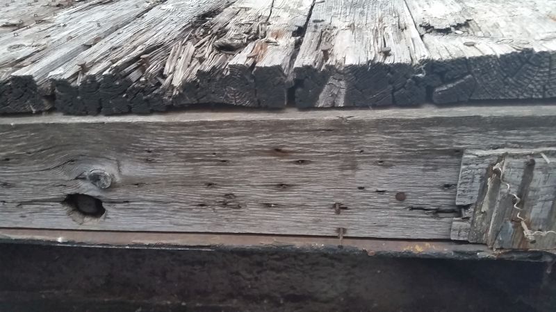

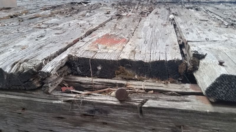

So I spent an hour at the Museum this morning picking up some blueprints for cataloguing and looking over/planning work for the winter months. As with many museums, we have a ton of work, and only a few people that actually come out to do said work. One of our upcoming projects is the reconstruction of our ex-CNR flanger. The floor was originaly 1 1/2" thick tongue in groove boards, with various widths from 4" to 8". The side boards were 2 3/4" thick and allowed for the tongue in groove siding to still be within the side of the steel beams.
So, with all that, my question is this. The floor is obviously shot, to the point where if you step on it, you'll fall through. Since it is only the floor, and the car is only for display, do we go with historic accuracy here, or just go with something simple in the lines of 2x6 or 2x8? The floor boards are all different widths anyways, so going with a standard 2x8 would give it a uniform surface.

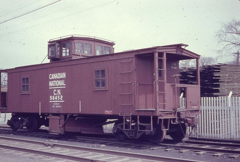

File comment: Our car in operation.

File comment: The upright was cut down on one end and put into a pocket in the side board.

File comment: Pic shows the different size floor boards.

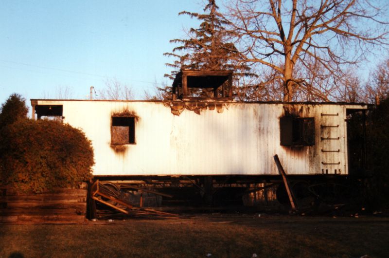

Richard, with the exception of the end platforms (about 32" each), the floor in these cars is protected normally. NRM's car lost its superstructure to a fire and that's why the wood has been exposed.

File comment: After the fire. Unfortunately we lost all the grab irons from the carbody as they were scrapped.
