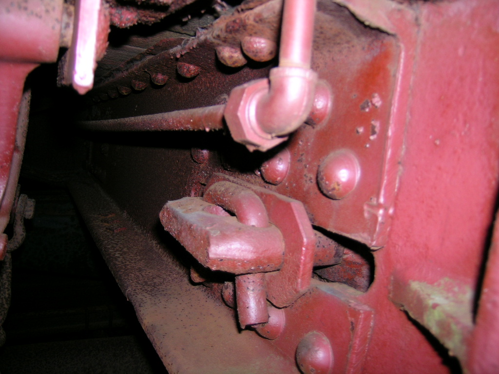

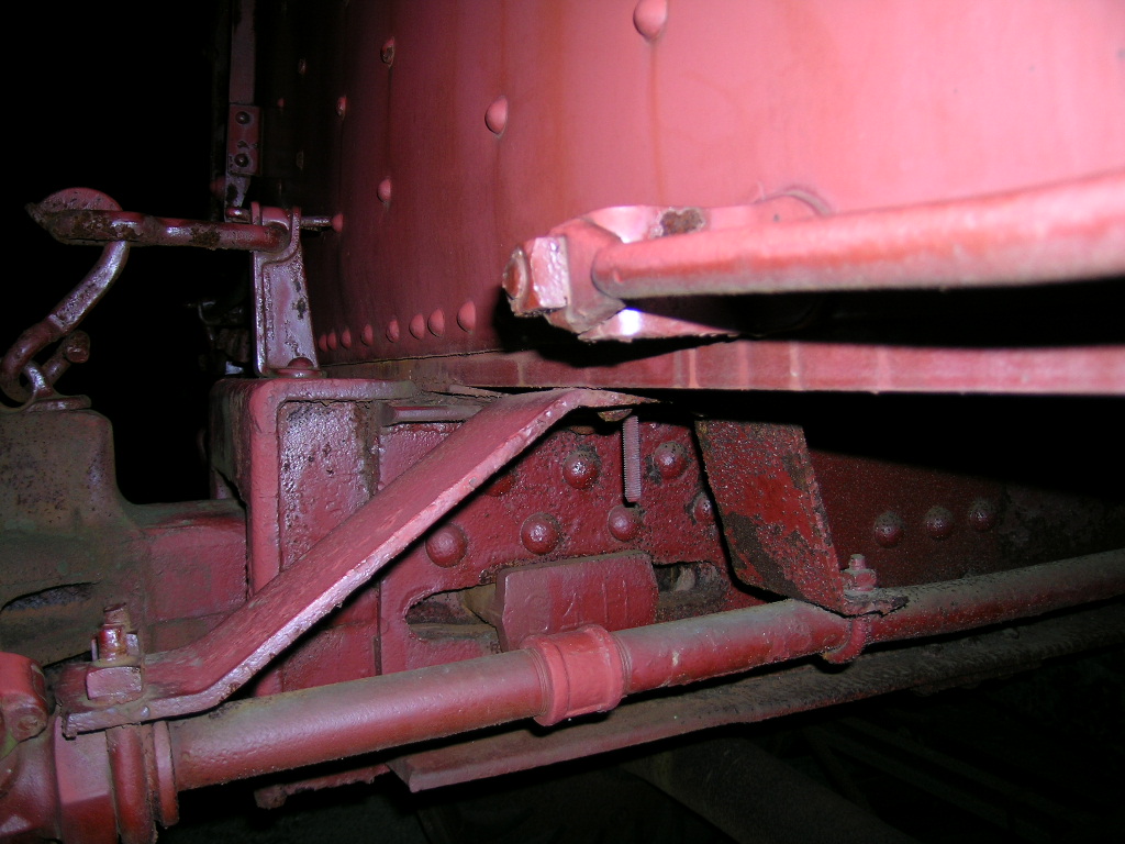

Some pics of a B&M boxcar coupler/cross key setup. I will grab some closeups of a troop sleeper coupler this weekend and post on Monday.
This photo shows the "pinned" end of the cross key; in this case, they used a piece of round bar as a cotter pin, and heated then bent the ends over as shown. Note the oblong washer against the draft pocket/center sill.
This photo shows the other side of the cross key, the "head" side. It seems they are usually inserted from the brake pipe side! So it has to be maneuvered into place around the brake pipe. The key head is marked "HTS" (high tensile steel) upside down.
Probably if the two U-bolts holding the brake pipe are removed the brake pipe could be bent out of the way.

Kelly Anderson wrote:
I was going to suggest putting the car between three SD-70's and 150 loaded hoppers which would be effective for removing at least one coupler, but Howard's suggestions are probably more practical.
Idk............this might be easier. Looking at that arrangement where you have to take down the trainline to get the key out......... I forget sometimes that some things have gotten easier to deal with on modern freight cars. Now if we could apply some of those same thoughts to making all the regulations easier to deal with.
