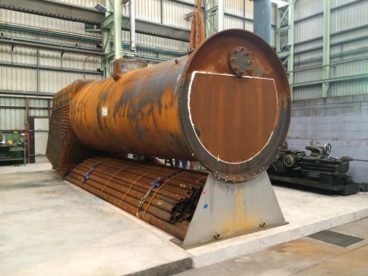

steamfan765 wrote:
If a locomotive needs a new boiler you might want to search around for the best bid from anywhere around the world.
Like maybe Meiningen?
Photo from somewhere on the internet of 3801's new boiler as delivered to Australia the second time.

3801s boiler for the second time? Didn't do too well on the British boiler either if I recall.

I had a discussion with someone (and who, I honestly forget) concerning the same thing at about the time the last OJ's were being built... namely, why not contract brand new boilers to fit some North American engines. The answer was (and I considered it an informed opinion) that the Chinese built a standard product to a standard plan, and were already in the process of closing down their production. They could build the boiler THEY wanted to build rather cheaply by US standards, but not the boiler YOU wanted... that would require new engineering, tooling, and fixturing that they were not particularly inclined to invest in... especially since according to government edict old fashion steam was officially dead.
It seems the experiences with several boilers built in the former East Germany bear out the wisdom of this position.
