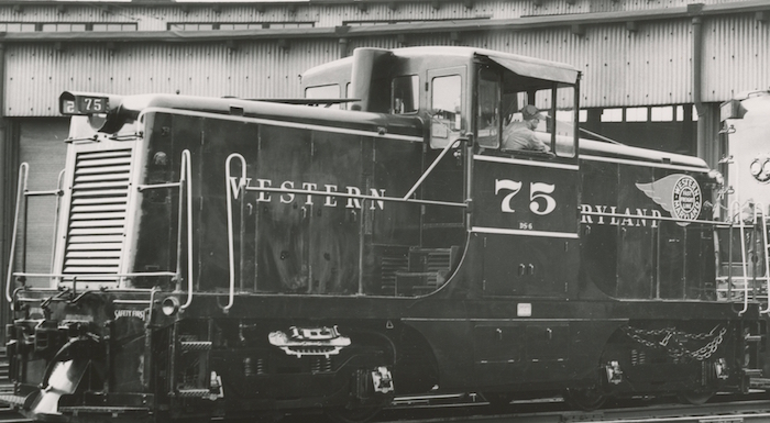

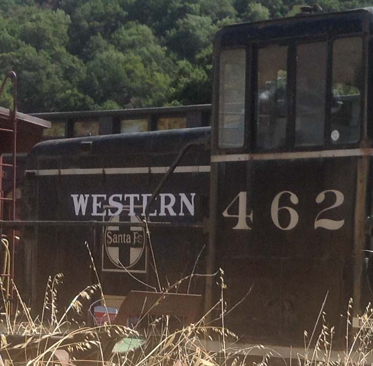

I'm working on getting the stenciling right for WM 75, a GE 44-tonner, and hoping to sanity-check my work with folks who know the WM. I'm not near the unit, and too much paint has fallen off for sanding to help. None of the 44's at WRM are the same generation, but Niles Canyon was able to help.
I have an original builder's photo courtesy WMRHS (twice the resolution I show here) and have "squared it" (more like rectangled it) in Photoshop and traced it in Adobe Illustrator. This was referenced to hard measurements taken on the NCRy unit, for instance the doors are 64.5" tall and 26" wide including hinge gaps. I printed it out and cut out a "positive" on paper.

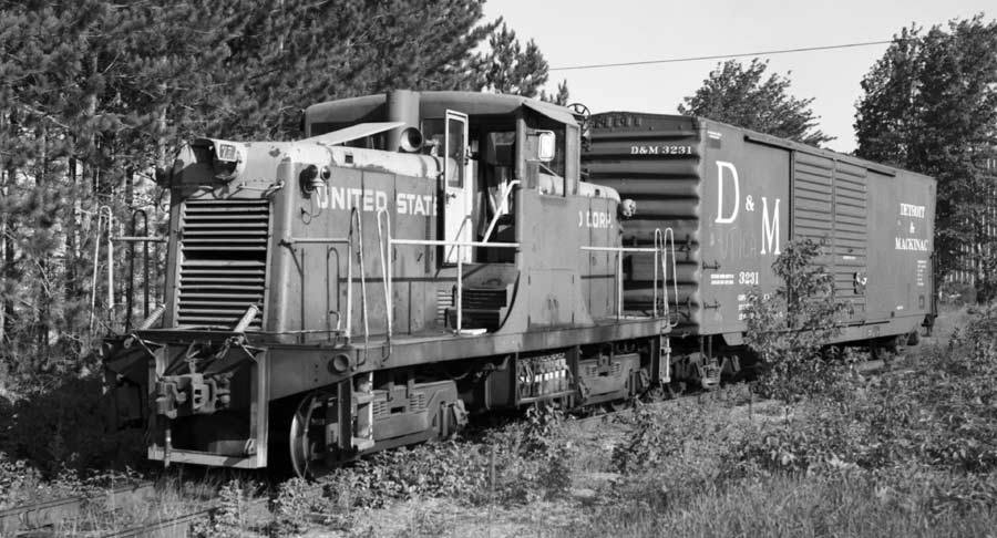

I tried to duplicate the angle of the builder's photo but a hillside and debris are in the way. As it was, I had to 'mow down' a bunch of that grass.
The test stencil seemed to come out exactly the right length but I struggled with vertical, finally arriving at 8" tall letters.
Anyone enough of a WM expert to tell me if I'm off the rails or if something needs fixing?

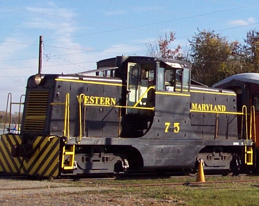

xx

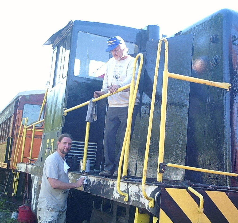

xx
 Post subject: Re: Need advice from Western Maryland fans on stencil
PostPosted: Mon Jul 27, 2015 3:28 pm
C Given wrote:
SMRS painted WM 75 in 2005 with the WM lettering; however, with the black paint chipping and MacDowell's robust enthusiasm for painting before approvals, it was repainted over without taking copies of the lettering. The lettering in 2005 was taken directly from the engine after chipping and removing brought out the lettering and a sign painter was brought in to copy and repaint.
Don't worry about it... the sign painter didn't capture the lettering exactly, note the S compared to the builder's photo, and the 5 definitely has problems. It may be a problem with stroke width, hard to tell because of flare in the color image, but EVERYBODY wants to make lettering bolder than it should be. Begs the question, if the lettering was traced in '05, why isn't the tracing on file?
As it is, good forensic work from photos will yeild a better job than you had.

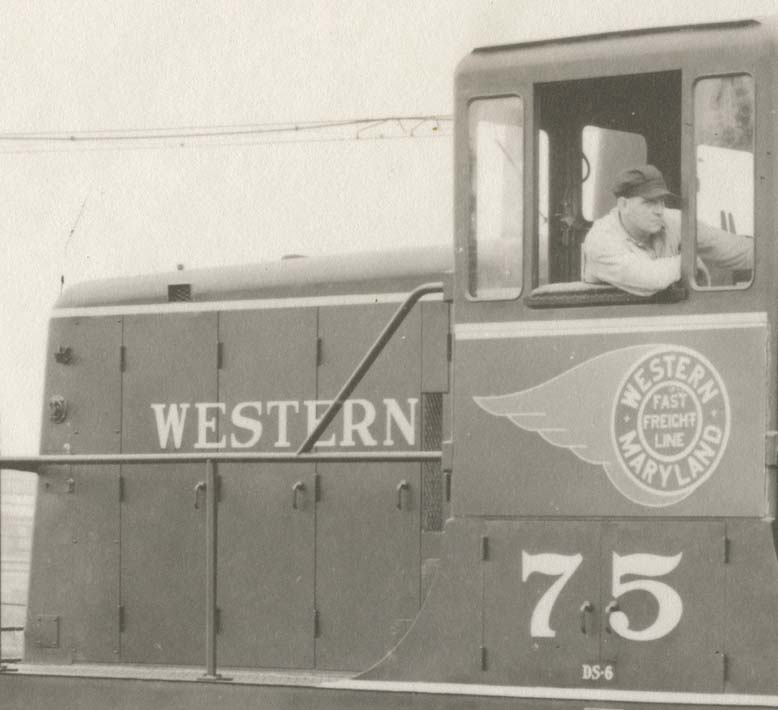

The "Western Maryland" on the hoods was plainly a clear fabrication with no tie to historic fabric.
http://www.railroadmichigan.com/southernmichigan.html
It looked like an Internet font and that’s what I think it was. It doesn’t match either the WM Phase 1 scheme. It is closer (but no cigar) and in the wrong position, to the phase 2 lettering:

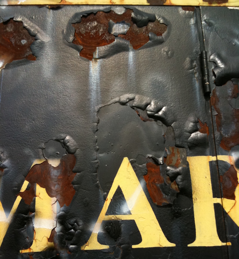

The artifacts reveal that the 2005 paint crew was struggling with massive paint failure, and would not have been able to sand-and-trace a reasonably complete tracing. In 2009 merely tracing the 2005 job would have impracticable and a fool's errand, since it's fake.
The paint failure harkens back to a problem at GE. They did not like to pickle their steel (remove mill scale) and delivered new units with fresh paint over mill scale. And fifty years later, it fails regressively in exactly this fashion, between the steel and the first primer coat. All historic layers are gone. This was discovered on SN 652 and 654; on the latter they removed all the old paint and applied Awlgrip; with the former they chipped the loose paint and used Rustoleum, and put it in Carhouse 3.

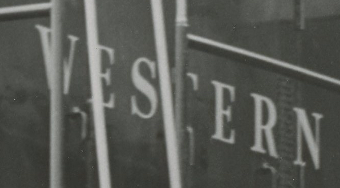

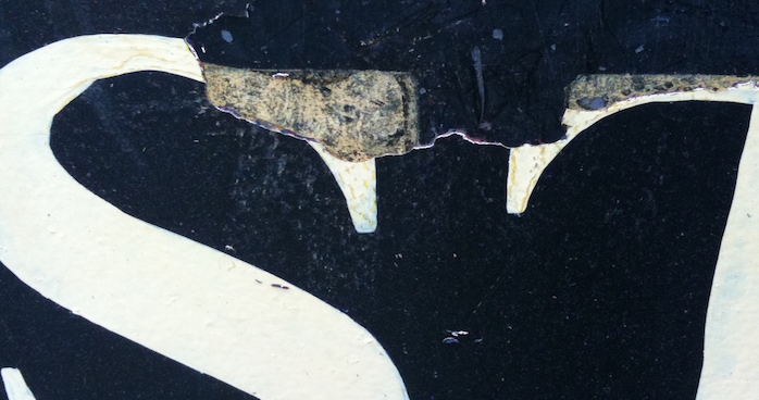

At first glance, that photo is impossible. From the positioning of the "S", you can only be looking at the WM "Phase 1" scheme, and there were several other paint schemes on top of that.
However, I have no doubt that you are looking at original Phase 1 paint. This is something we ran into elsewhere on the unit: delamination between the phase 1 topcoat and the phase 2 primer, allowing it to peekaboo through "intact"... but only in particular spots of its choosing. I assume this had to do with fuel-oil splattering during switching moves in the shop. It did not take kindly to efforts to further separate those layers, as you can see at the rainbow edge. And of course, anywhere the bare-metal separation occurred, the first layer was lost too.
Might have helped in 2002, but there were a LOT of layers of paint and it probably would've taken 100 hours of expert work to expose a meaningful amount. Here is the 2002/5 topcoat over phase 1.
