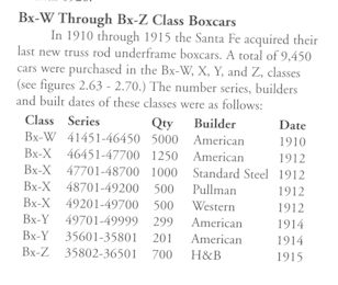

The best reference is the following:
    Santa Fe Railway Rolling Stock Reference Series -- Volume Four
    Santa Fe Boxcars 1869-1953
    By John C. Dobyne III
    published by the Santa Fe Railway Historical and Modeling Society, Inc.
Finding the information in the book would be quicker if the cars showed (and you noted) the car class. It appears that 44942 is class Bx-W and 48259 is class Bx-X.
The class number is based on the first and last letters of the car type word and then followed by a alpha (and later a numeric) sequence character(s).
Instead of transcribing the information here is a scan of a portion of the write-up about the classes of similar cars.

With the class designation I might have found the necessary page in the book a minute or two quicker. From the scan you can see the class associated with each number series.
The SFRH&MS may have additional information in its reference library collection. Years ago, on behalf of OERM, I obtained the sales date of our car from a Santa Fe car record collector. After he died the Society filled half a box car with his collection to ship it to its collection at Temple, Texas.
HO-scale, resin kits of these classes are available from Westerfield.
Here is the Westerfiled information page for the Bx-W, X, and Y class models. And here is the page for the Bx-Z cars.

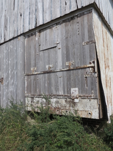

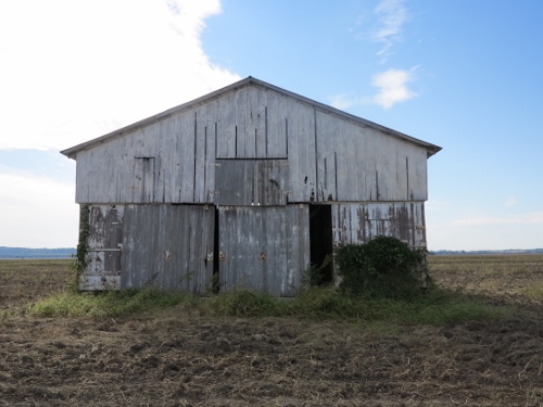

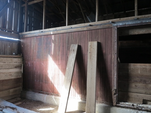

 Post subject: Photos of AT&SF 44942 and 48259
PostPosted: Thu Sep 24, 2015 9:35 am
Posts: 288
Location: Bendena KS
Thank you everyone for the replies and information. Now we know that AT&SF 44942 is a BX-W built in 1910 and 48259 is a BX-X built in 1912.
Both cars were retired and moved to their present location (north of Atchison Kansas) around 1935-1940. (from what I could read of the lettering on 48259, its last weigh and repack dates were in 1935). The cars were made into grain storage bins and a barn was built over and around them.
Times have now changed and the barn is in the way, current landowner wants it gone, but does not want to just destroy the cars.

File comment: AT&SF 44942
File comment: The end of AT&SF 44942
File comment: The barn. Note the ends of the boxcars peeking out
 Post subject: More photos
PostPosted: Thu Sep 24, 2015 9:49 am
Posts: 288

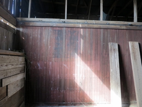

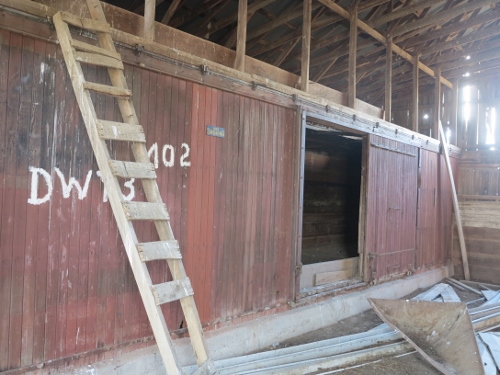

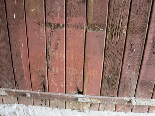

Both cars have had their steel underframes removed, along with grab irons and other metal bits. Wood bodies are in amazingly good shape, having been mostly under cover and up off the ground (cars are sitting on brick pillars, about 18" above the ground).
Cars are available and in need of a good home. Landowner is enthusiastic about seeing them saved. That said, it is desired that they be gone by March of 2016. If anyone is interested, PM me. Cars will be relatively easy to get at until it gets muddy.
Jason Midyette
- as a side note, every bit of information I can find on line on these cars (Santa Fe BX-W to BX-Z), shows them with the Santa Fe Herald , reporting marks and car number etc, on the right side of the car. (As 49131 at Orange Empire is presently painted) 44942 and 48259 buck this trend as such lettering is on the left side of the car, as seen below. Did the Santa Fe change the lettering layout between 1910 and 1930? (probably basic info for a Santa Fe fan, but my wealth of trivial tidbits is fairly much limited to Colorado narrow gauge cars)
File comment: AT&SF 48259's lettering. Worn but mostly readable in the right light.
File comment: several layers of repack dates on 48259
