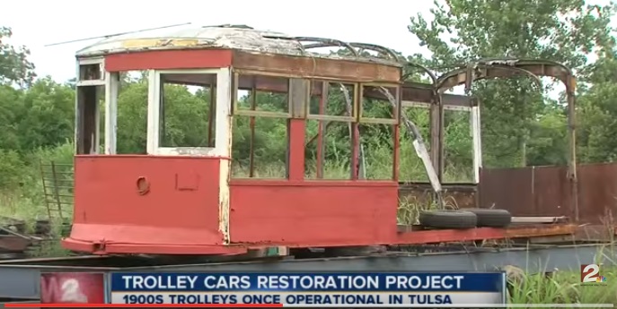

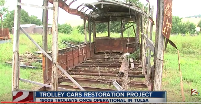

Some projects start with empty shells. These are in Sand Springs, OK.
Aug 28, 2015 news video: https://www.youtube.com/watch?v=-v1B4fWh0MY

What do you think is the best approach? One at a time, or all three at once?
 Post subject: Re: Tulsa trolley project
PostPosted: Fri Sep 18, 2015 1:14 pm
If the cars are very similar, it makes sense to make the most of your setups when you mill new parts - might as well make all you need for all three. Whether you actually repair all three is more a marketing decision than a practical one. Having one done as a showpiece could be useful when working on funding the other 3. All else being equal, I'd do all three at once if at all possible.

Per the FB page, the 3rd car - the car painted in yellow primer, is to be used for parts to restore the 2 Tulsa cars.

Ah. In that case I would probably metal out both cars at once to stabilize them, and then at least cut all the rough bucks for the woodwork at the same time. Then I would probably focus on one. Quite an ambitious project if they do not have a parts stash.
