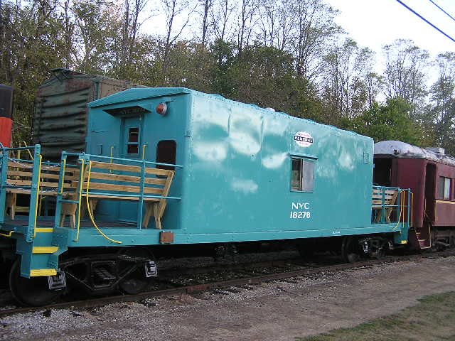

The Whitewater Valley Railroad just completed this NYC transfer caboose. The herald is smaller than the one you need, but it was made from three layers of vinyl. I have seen several of the originals that appear to be screen printed vinyl. Our curator had this made by a company in Cincinnati who could easily scale it up for you. PM me and I can get his contact information to you.

With something this large IRM would probably not use a vinyl herald. If stored outside the edges will start to peel up in around 7 to 10 years.
If stored indoors I would consider painting the black and white background and then applying vinyl lettering. You still need to produce scale artwork to have the vinyl cut.
You can also use vinyl as masking if you don’t have the hand lettering skills.
I might do this as follows.
Paint the entire background white.
Mask the word CENTRAL with low stick vinyl lettering. You can have a sign shop produce that (don’t let them use a stock font, ask for a proof) or you can cut it yourself from raw stock.
Paint the black areas and remove the mask for CENTRAL.
Mask and paint in the red words.

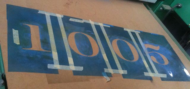

There are several ways to do lettering. The "truly traditional" way was hand lettering, and this was a craft of the masters. If you want to hear about that, one of the more knowledgeable folks is Fred Krock. However that type of logo would not have been hand painted, first it's too modern and second there are too many precise curves.
Another way is stencils. I'll attach a picture of one of the WRM's stencils. It is a sheet of mylar, about 1/100" thick (10 mils). They are reusable. This one was laser-cut from an Adobe Illustrator drawing. For a multi-color logo like that you would need several stencils.
On this stencil, you see the residue of clear varnish. Why would you stencil varnish? It's being used as a glue for gold leaf. Gold leaf is an extremely thin sheet of real gold, lightly stuck to a backing paper. The varnish is applied, and stencil removed. When the varnish gets tacky, the gold leaf is rubbed over it, sticking only where there's varnish. Then the backing paper is lifted away. I'm mentioning this for a reason.
When I say "varnish" I mean either a traditional oil-based varnish, or a modern epoxy or polyurethane varnish, all of them being clear in color, and water-resistant.
Another way to stencil is to mask, i.e. masking tape. One way to do masking is use vinyl letters AS masking. This avoids the durability problem. But you have chemical compatibility issues - will the sticky-goo interact with the fresh paint you're sticking it over, and will the paint you're spraying melt the vinyl, and will the adhesive remover you use to get the sticky-goo off also strip the paint? Murphy's law: this will be worst when you use the best quality paint.
Another scheme is decals. Of course you know about vinyl decals - essentially bumper stickers. There is another type any modeler will know - a "water transfer" decal stuck to a piece of backing paper with water-soluble starchy glue. In models, you soak the decal in water, slide it off and to the model, and the water-soluble glue holds it to the model. That water-soluble glue is a real problem outdoors. The solution is to apply the decal similar to gold leaf. Paint waterproof varnish on the car as a glue, then apply the decal face-down (paper out) onto the varnish. The varnish glues the face of the decal to the side of the car. Once the varnish dries, soak the paper to remove it - the decal itself protects the newly dried varnish from the water. Then wash off the water-soluble glue off the outside of the decal; you don't want it, and its job is done (holding the decal to the backing paper).
