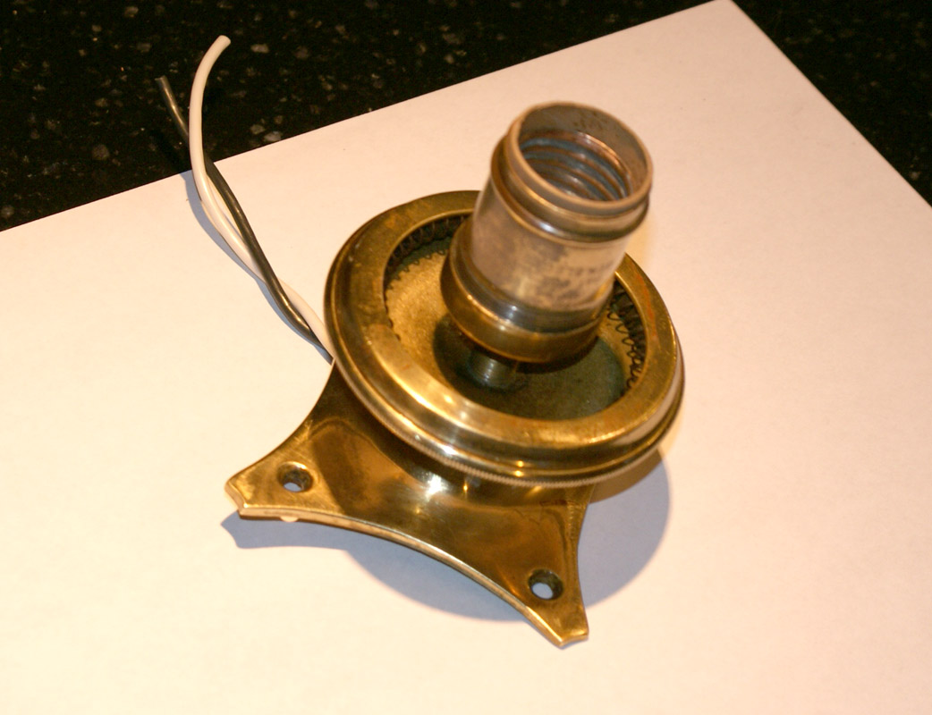

I recently needed to clean up 90 year old brass light fixtures. Some areas completely black with baked on soot and grime. I do not like removing any original finish. Brushing and buffing an antique to a shiny bright brass finish is just heresy.
What I used here was oven cleaner. Put the brass parts in a covered plastic container sprayed and brushed on the cleaner then let it stand covered for two hours. Hand sprayed with water and a soft brush and the grime simply fell off.
The brass had been lacquered and some of that came off but it was quite dirty. After rinse and dry I took the rest off with a little lacquer thinner. Then applied a little mild brass polish and hand buffing. Finally re sprayed with a thin coat of clear lacquer.
Don't have a pix of this fixture but it turned out similar to the one pictured here.
This is for a 100+ year old Pullman, and I think leaving the patina is the right thing to do.
Larger parts could be wrapped up with plastic then sprayed.
May be the metallurgists in the group can comment on oven cleaner being bad for the brass or not.
