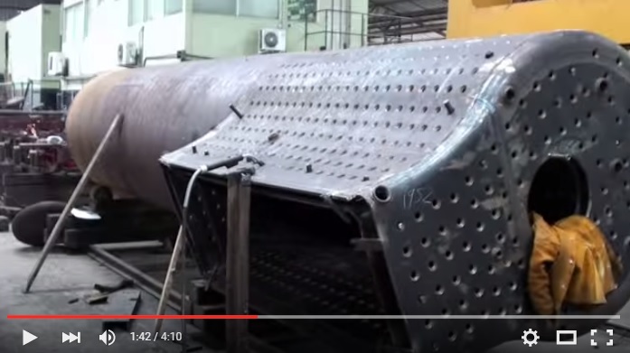

After spending some time watching videos of Ecuadoran steam on Youtube, I ran across one posted on February 2015 by the Ecuadoran company, Metalmecanica Comercial SA ("Metalco"). The video shows the rehabilitation of steam locomotives #14, 18 & 58 for the Ferrocarriles del Ecuador. I don't read Spanish, but I believe it says the work on these three locos was completed in 2014:
Proyecto de rehabilitación de las locomotoras 14, 18, y 58 para Ferrocarriles del Ecuador llevado a cabo por parte de METALCO S.A. en 2014
The video shows scenes of the rebuild work in progress, followed by the finished products rolling out. These are some dandy machines.
https://www.youtube.com/watch?v=E1gAWCfnri0
Below is a snap-shot from the video.

Looks like they are using a wire feed to weld up the pressure vessel. I believe that is frowned upon in the states. Sub-arc is OK but wire feed isn't approved. Hope they hang together.

Nice flanging on the knuckle radius. Do you suppose it is built to a code? Do the Ecuadoran have a national code? It was obviously designed by someone who knew something.
CCdW
