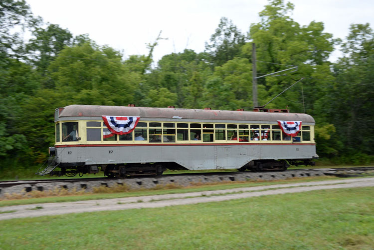

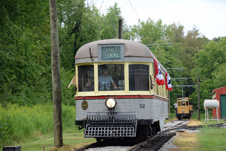

August 14th was the Members Day Picnic at the Northern Ohio Railway Museum. It was more than just a day for the Museum faithful to gather, reflect on the past years accomplishments and dine on a selection of grilled delights and other treats. It was the first day of electric passenger operation at the Museum.
We ran Shaker Heights Rapid Transit Car 12 on her own off the overhead for the first time. Cleveland Railway Crane 0711 was parked on the end of the line supplying power to the overhead. A gas engine generator and rectifier setup is located on this work car. This would be the source of the 600 volt DC.
Car 12 received bunting as a nod to history. In 1954 when the Madison Ave. streetcar line in Cleveland was converted to busses, several of the cars in service received identical bunting for their last runs. This was the last streetcar line in Cleveland. We decided to do the same decoration, but to celebrate the start of electric operation.
Further work is needed at the Museum before we will be ready to offer trolley rides to the general public, but we expect to begin offering demonstration trolley rides sometime in 2017.
File comment: August 14, 2016. First run off overhead at Northern Ohio Railway Museum.
