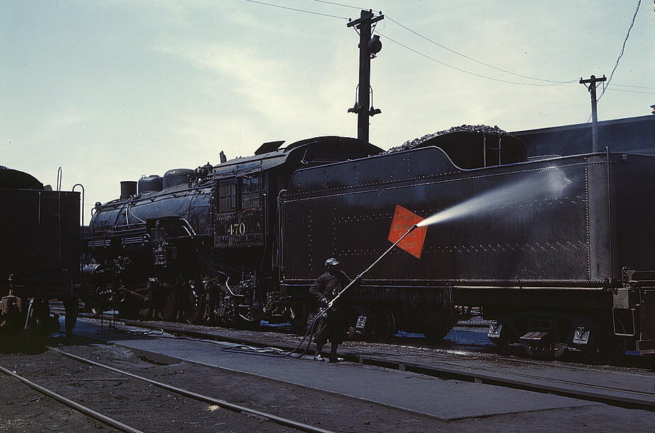

PostPosted: Sun Aug 16, 2015 5:34 pm
Hope this poke to an old thread is meaningful.
See this photo? Notice how the spray wand has TWO hoses attached. What do you think the hoses are?
Chicago,_Milwaukee,_St._Paul,_and_Pacific_Railroad_470.jpg [ 123.7 KiB | Viewed 10757 times ]
 Post subject: Re: Cleaning Steam Power
PostPosted: Sun Aug 16, 2015 7:25 pm
Joined: Tue Mar 02, 2010 5:03 pm
Posts: 261
Location: SE, Mich.
Probably air and water to create a high pressure stream.
-Aaron Farmer
Manager, Mechanical
Steam Railroading Institute
Yield not to misfortunes, but advance all the more boldly against them.
PostPosted: Sun Aug 16, 2015 8:36 pm
Posts: 841
big-bad-2666 wrote:
One is steam, the other is hot water.
PostPosted: Sun Aug 16, 2015 8:49 pm
There may be kerosene mixed into the hot water as well.
