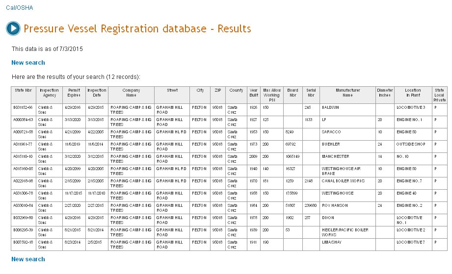

If there is a State number on it, the records probably exist and are probably searchable on the CA PV website.
Search of the word "roaring" spit out permitted objects at Roaring Camp & Big Trees RR.
CA PV Database

Thanks for the tip on the California pressure vessel site. I tried the boiler number and got nothing. Another source told me that the state probably has the records on micro film but has no manpower to dig them out.
