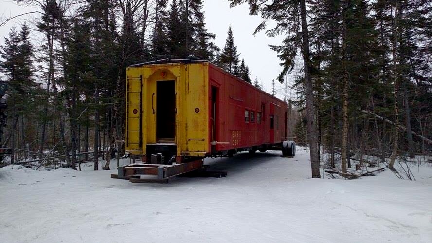

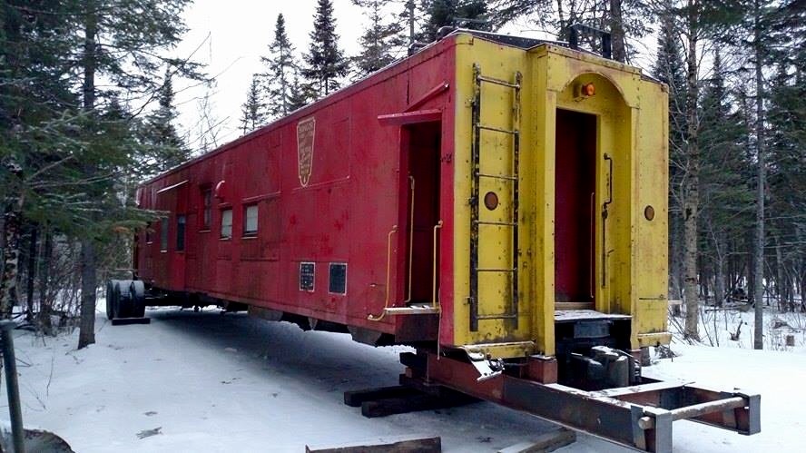

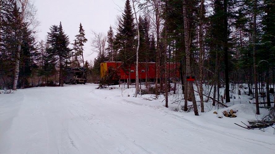

It has been a long road! Check out the date when I started this thread. It was all worth it in the end, as it is finally on my land. The saga began when I purchased land, then went looking for a caboose to make into a home. The first purchase was a MEC center cupola steel caboose. That was a no go because it was too tall. Cutting it into pieces to transport was not acceptable and the owner graciously refunded my money. I found the troop sleeper the next day, but it took months to even find a contractor and I went through 3 before I had success. First guy was the one who placed it so I thought he would be the guy for the job. Turns out he had mental issues and was incapable of moving a truck much less my caboose. Second guy didn't have the equipment he thought he did and was unable. Finally, third guy who moves homes and camps was able to listen to my suggestion. He placed a custom hitch on one end and axles and wheels on the other and towed it to my new place. No crane needed. I am so excited to finally be done with phase 1. The caboose was 6K and the move was 4K so I am pleased. Others have spent far more. Now this BAR troop sleeper caboose resides in the northern Maine woods! C90 is home!

For the rear wheels it was 2 custom axles. We opted for outrigger style placement of the actual wheelsets in order to keep the height below 13'6", the legal max height in Maine. For Mycenaean short trip of 25 miles on rural roads I would've been given an additional 6 inches if I needed it since the load was not reducible in height. As it was it was just under the 13'6" limit. For attachments, there were two metal I-beams welded and screwed onto the underside of the car to support the axles on the edges. Holes were drilled in the centersill, and large U bolts were used to secure them in the middle. Two axles were used, and they were dual wheels on each side of the axles for a total of eight wheels in the rear. The front hitch was a totally custom job, built on site And screwed and welded into place around the coupler to avoid having to cut it off. A special lift rig with its own motor was used to connect the hitch, and that connected onto the traditional semi rig using a kingpin. It was not without difficulty, as this car was very heavy and he was going to little too fast during the first leg of the trip. He had a small bump and part of the hitch broke and had to be re-welded to continue the journey the next day. Once he realized he needed more reinforcement rest of the trip went smoothly.
