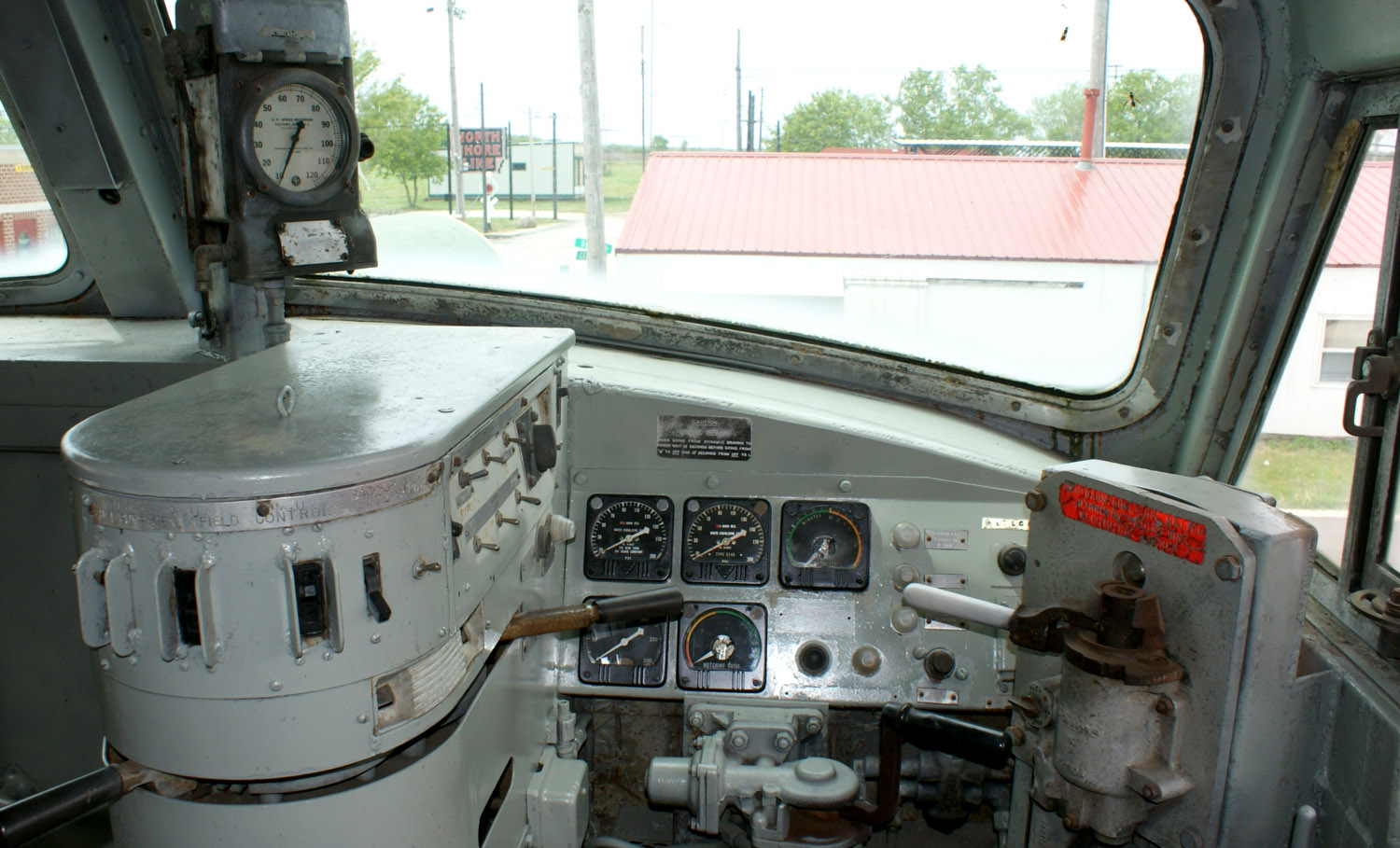

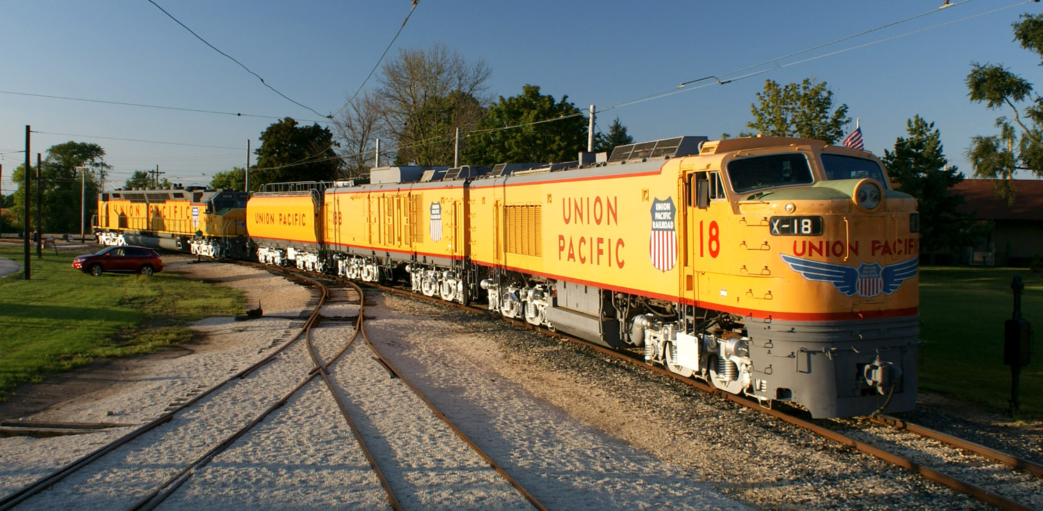

Took some time but I located a cab photo of 18 as well as a shot on the west wye with UP 6936 .
Having a DD-40 MU with a turbine was a not too uncommon sight back in the day.
The cab as well as most of the A unit is pretty complete. We had at least one Rail Sim company come out to do the cab interior for a simulator game. One way to take the turbine out for a spin right now.

File comment: 15,000 HP on West Wye

File comment: UP 18 cab 2012
