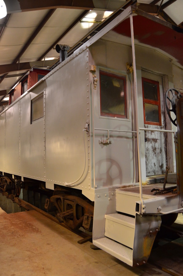

Car in question is New Haven NE-6 class C-694, built 1947 by International at Kenton, Ohio, and later used on Pittsburg & Shawmut in Pa. (1966-1994). The old sash appear to date from the P&S era.
Car inside Thomaston Shop, October 2014:
